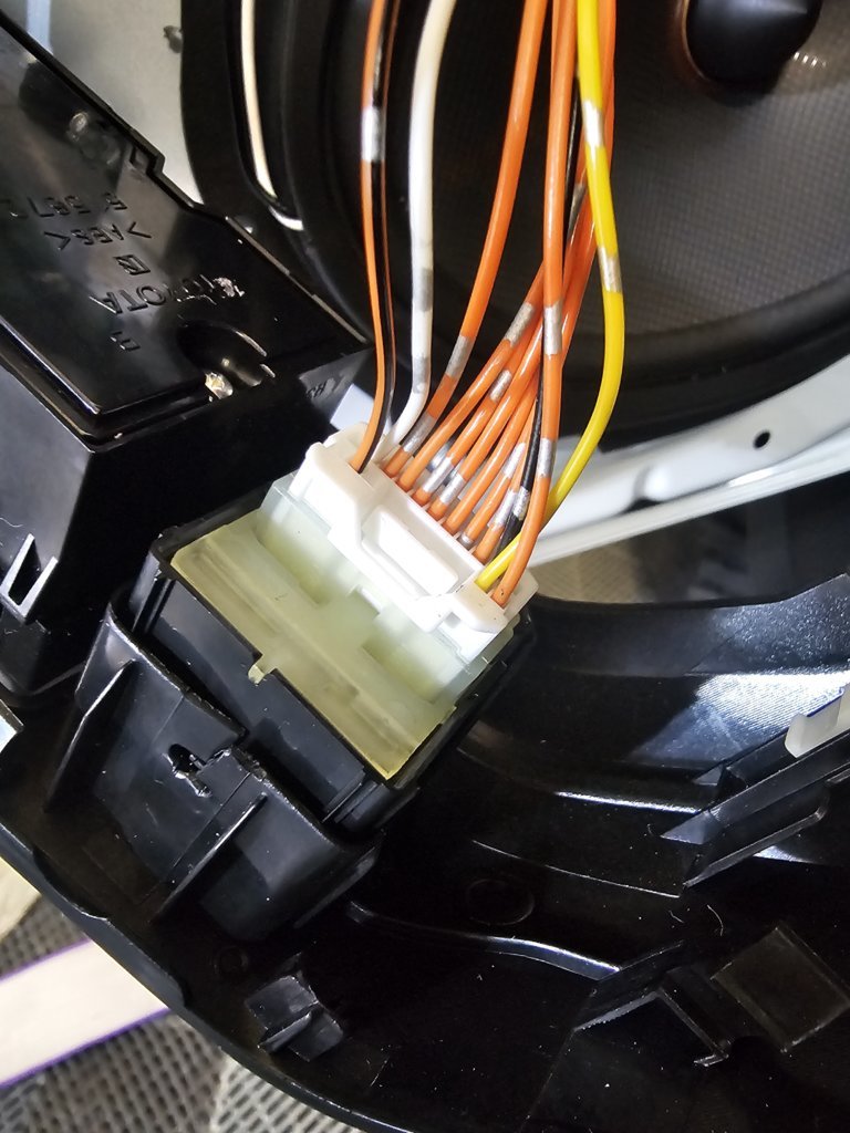

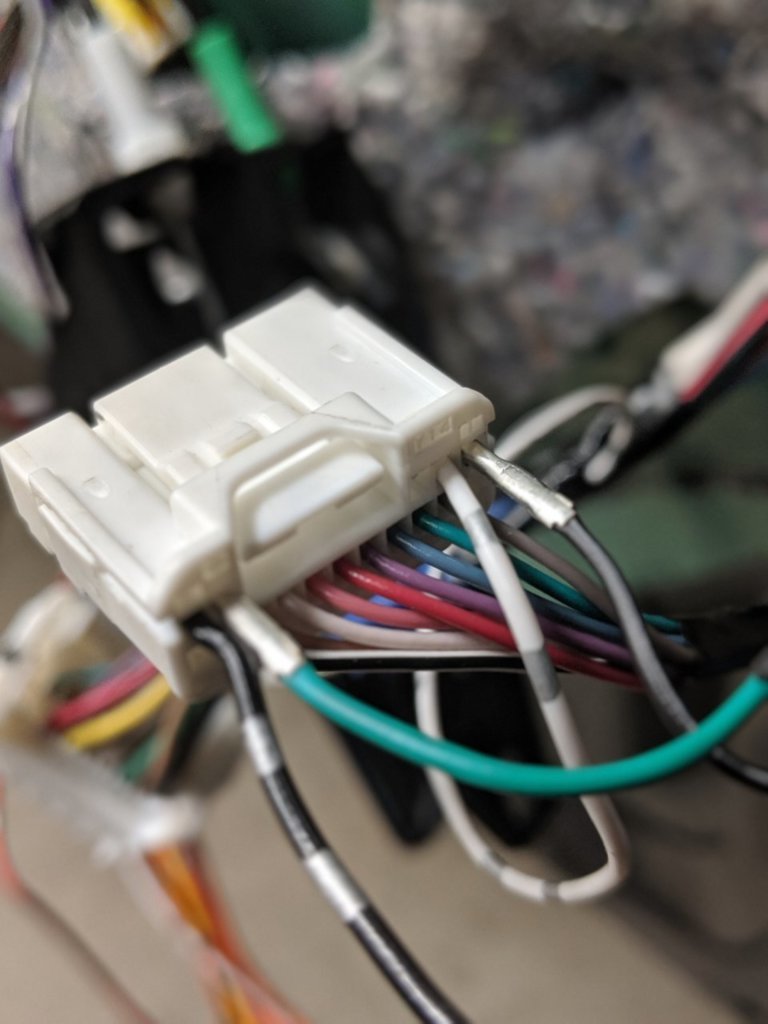

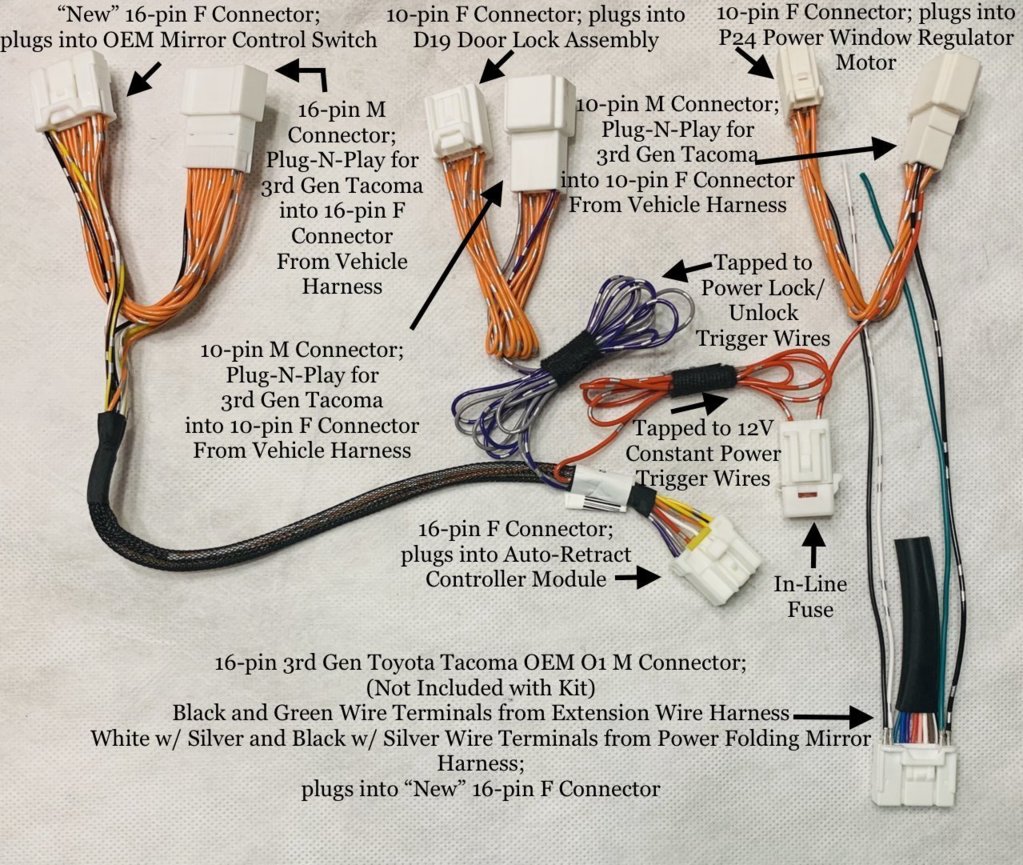

    Ok there is a fuse in the harness that was blown...But I still need your expertise...at this point when I use the fob or the switch both mirrors work out of sync...the passenger is open while the driver side is closed or vise versa...so obviously I need to unpin and switch a few wires...take a look at this diagram and my pics please my 23 seems to have slightly changed
    Thank you

    When you use unlock on fob, mirrors should go out or unfold. When using the lock, mirrors should go in or fold. Look which mirror is running backwards and check the wires for that mirror. Your wires colors look different as you stated, than mine. Mine are 4 years old. Looking at some notes I have.

    The driver side is the one acting wrong should I just swap those 2 wires

    You could try it, just double check the wiring

    Fixed i verified it with a fused q2v line straight from battery plus ground

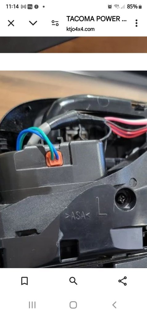

    Plug in play 100% missing wiring harness motorsScreenshot_20250330_111405_Chrome.jpg
