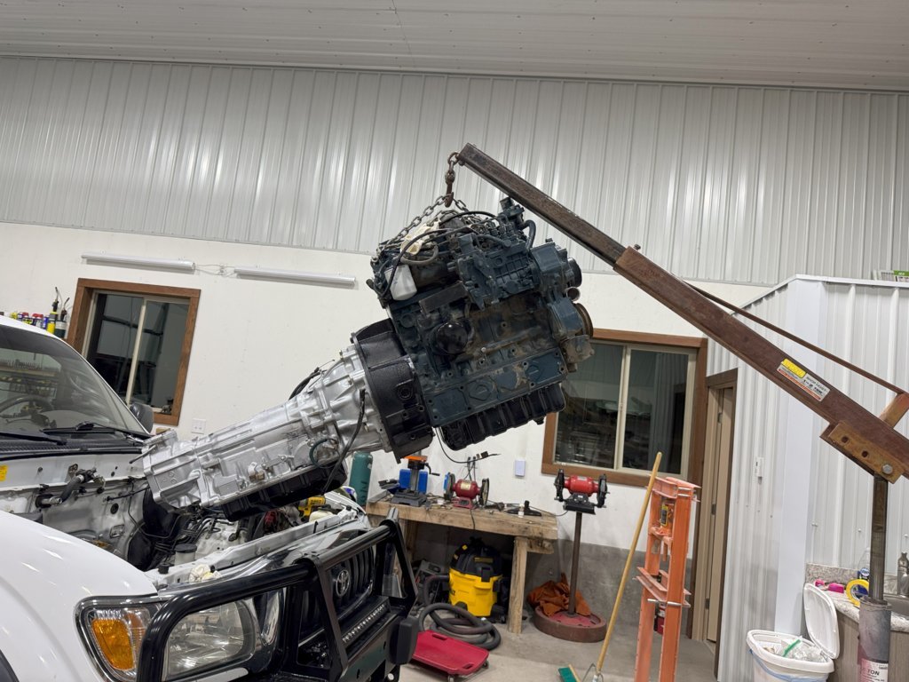

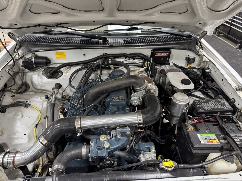

    I have done a diesel swap in my Tacoma. I am having a some transmission hard shift issues. Brand new built transmission with a stand alone controller. I need help deciding if I have to replace the valve body or the transmission completely. Does anyone have a good understanding of the internals of a 340F? I have about 500 miles and the swap and everything is good except the the shift issue.

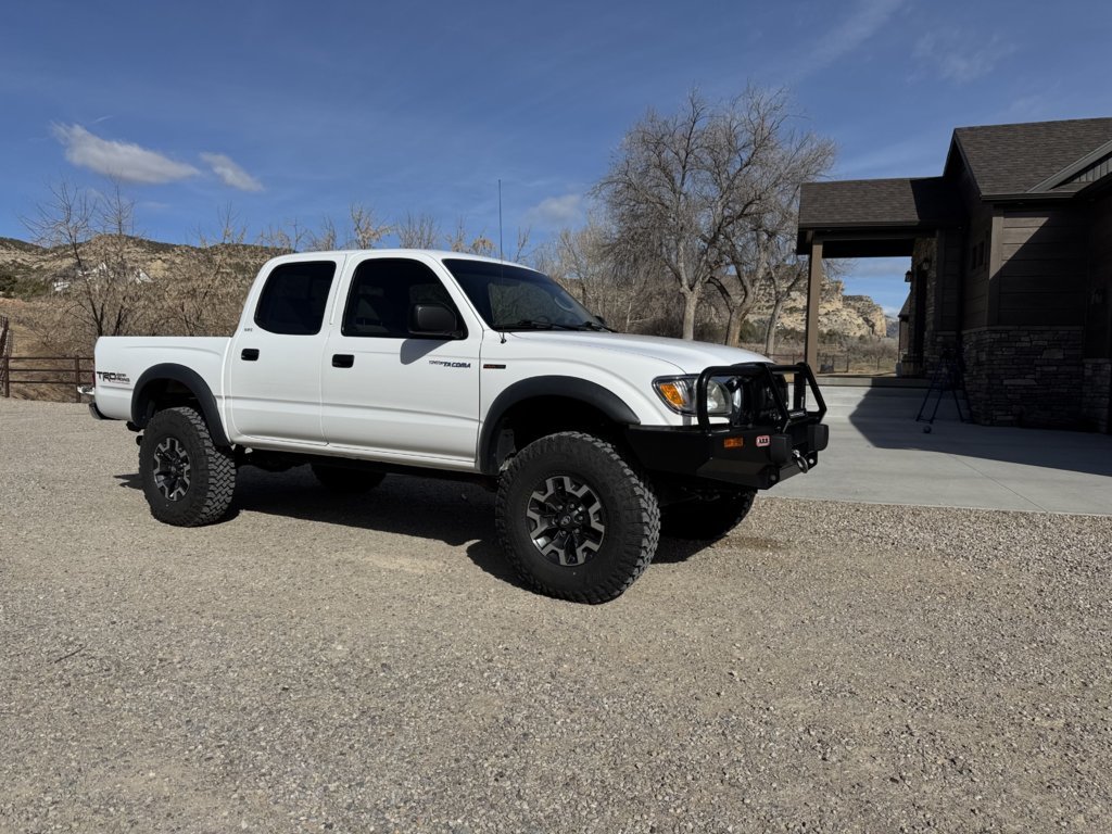

    Well, it all started a couple months ago when I got a wild idea for a motor I had.. So, I found a clean first gen and embarked on this project. Couple months later it’s rolling a little coal and I love it. IMG_9142.jpg

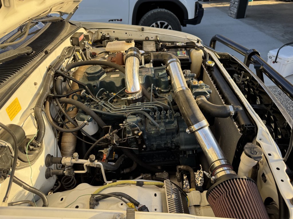

    Do you not have an air filter on that? Looks like the air intake is piped straight to the wheel well. That cant be good for it :confused:

    Definitely has an air filter.

    Curious as to final drive ratio, all diesels I have had have had a 3.53 or lower, numerically, rear end.

    It has the stock 4:10 gears. It tops out about 75mph. It cruises around town perfectly. It wont be used for long trips. It is perfect for what i wanted, 30-55mph it drives great. 22-25 mpg and right in the RPM sweet spot.

    Which Kubota diesel is it?

    3600 T

    I’ve wanted to do this since the Roxer came out! Did you make your own adaptor and motor mounts? So cool

    I had to make or have everything made. I could not find a single other one that had ever been done with this engine. Luckily it all worked out and is great to drive.
