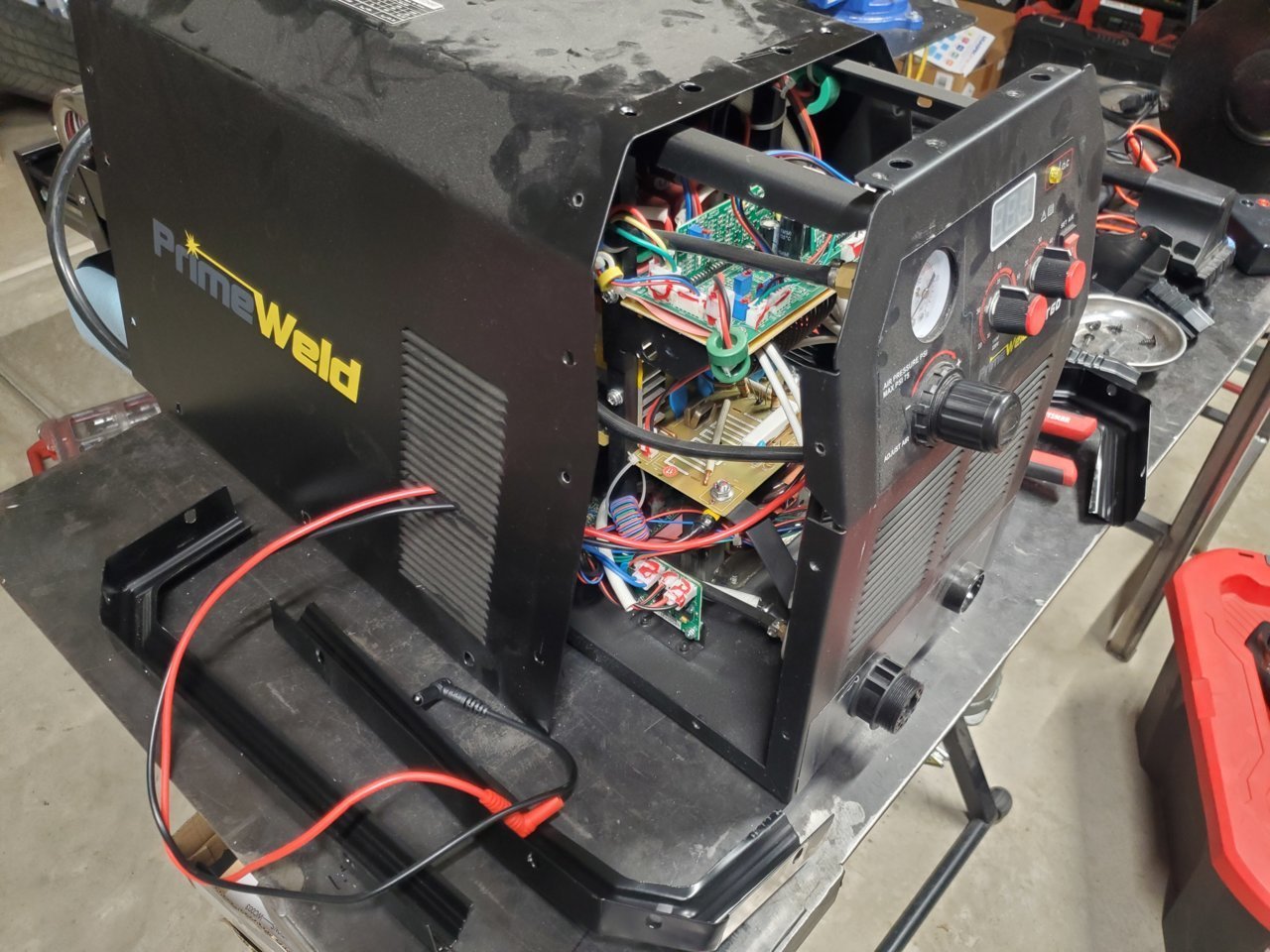

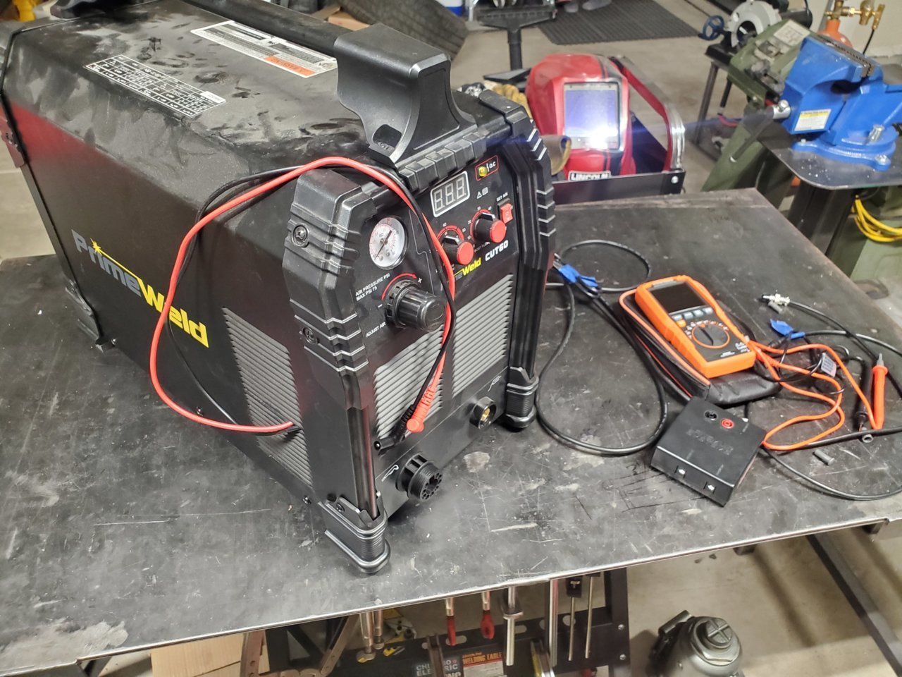

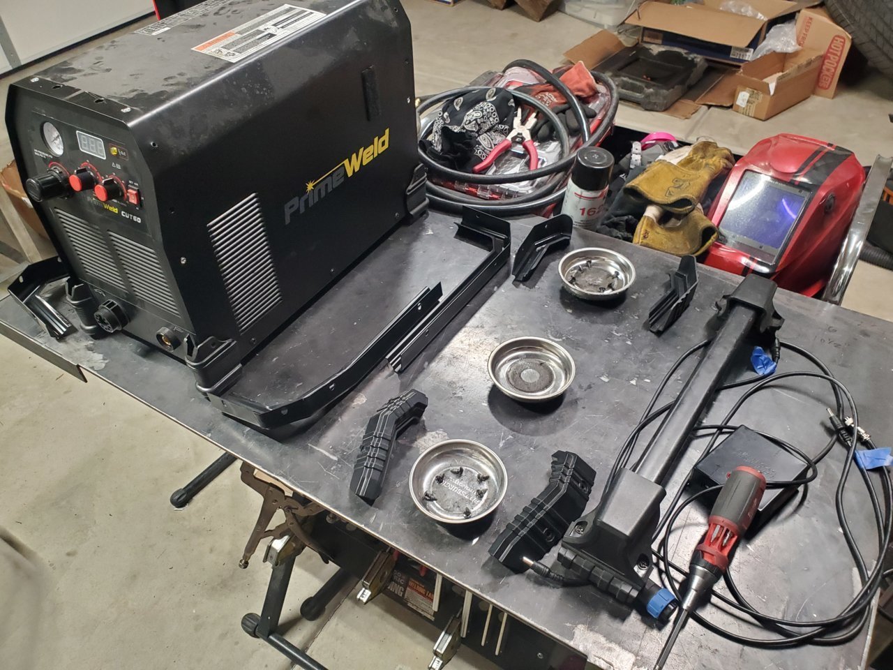

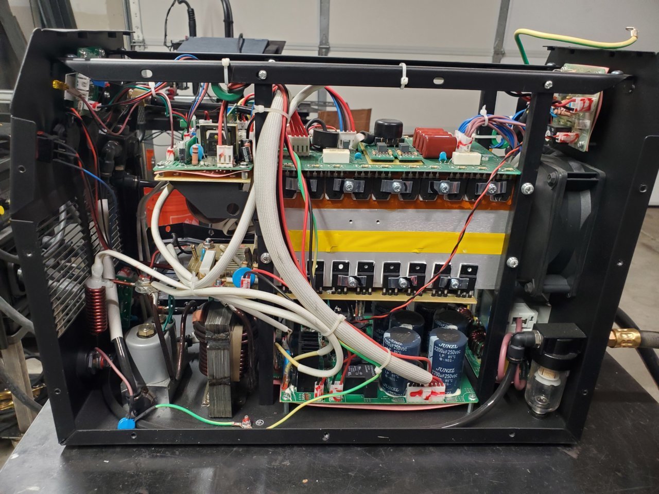

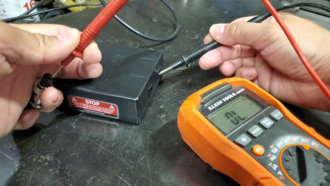

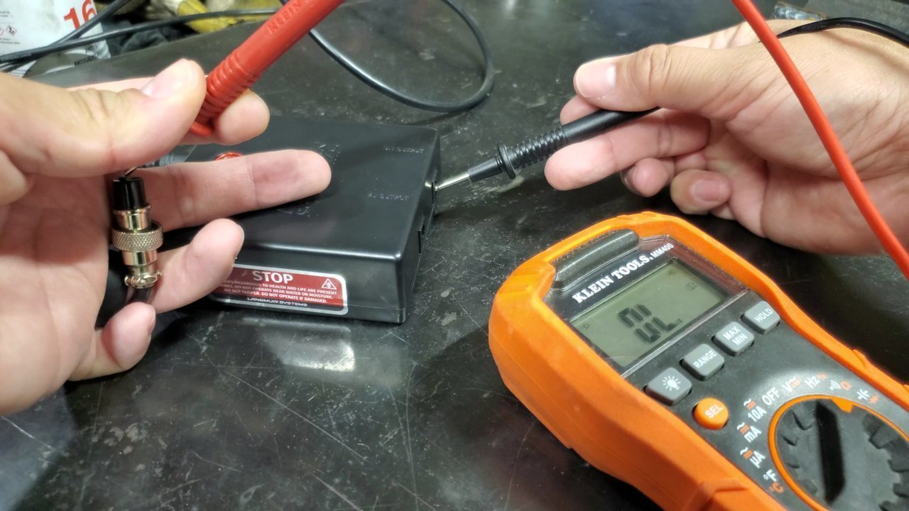

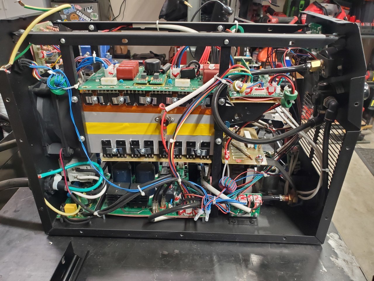

    Still appreciate everyone's patience; waiting on a replacement module as my system has been down for about a week now :laughing:
    Pictures for entertainment purposes

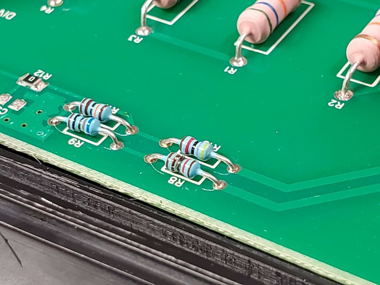

    Lots of troubleshooting, narrowed down to this little module
    The bad resistor; R8 is burnt but take a look at the cold solder joint on R9 as well :eek:
    While I wait, decided to tap into power the alternative method versus using the cnc port
    Should be back up and running by the end of the week!

    It's less Tacoma and more mod
    R9 ain't a cold solder joint, it's a no solder joint

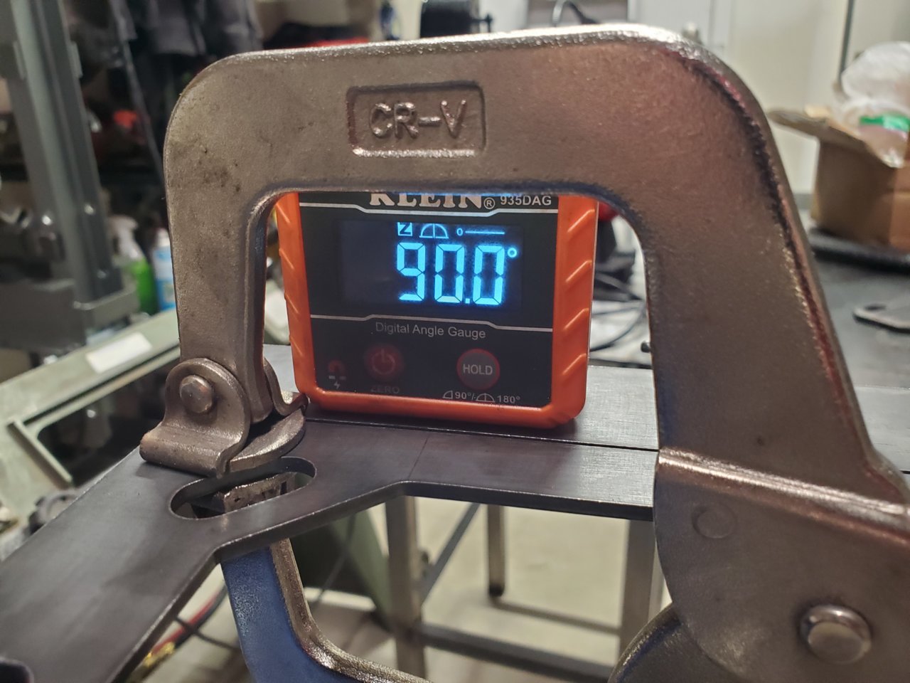

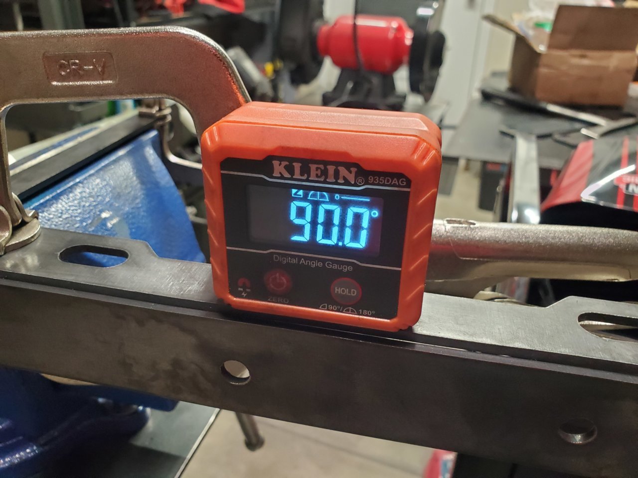

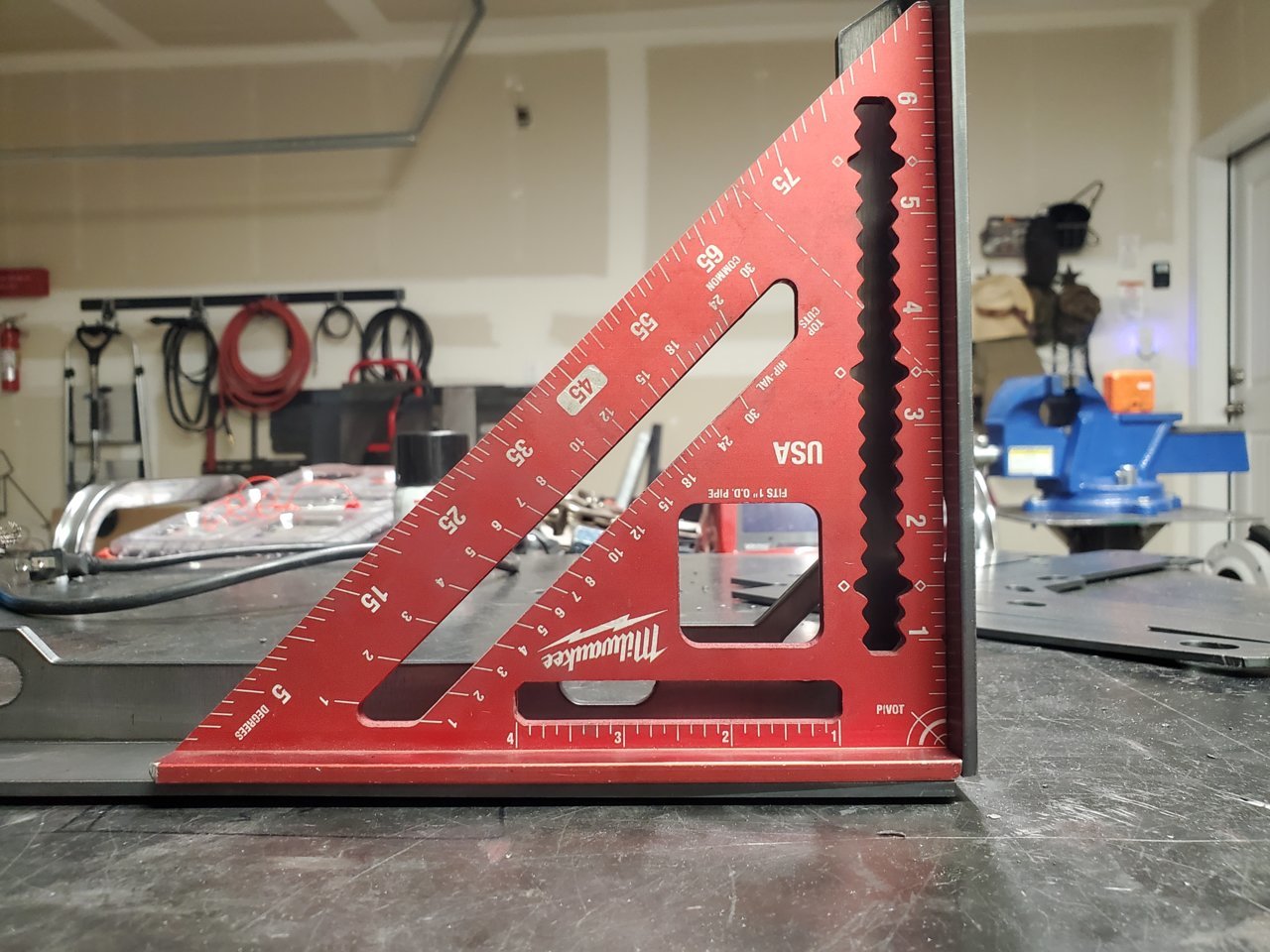

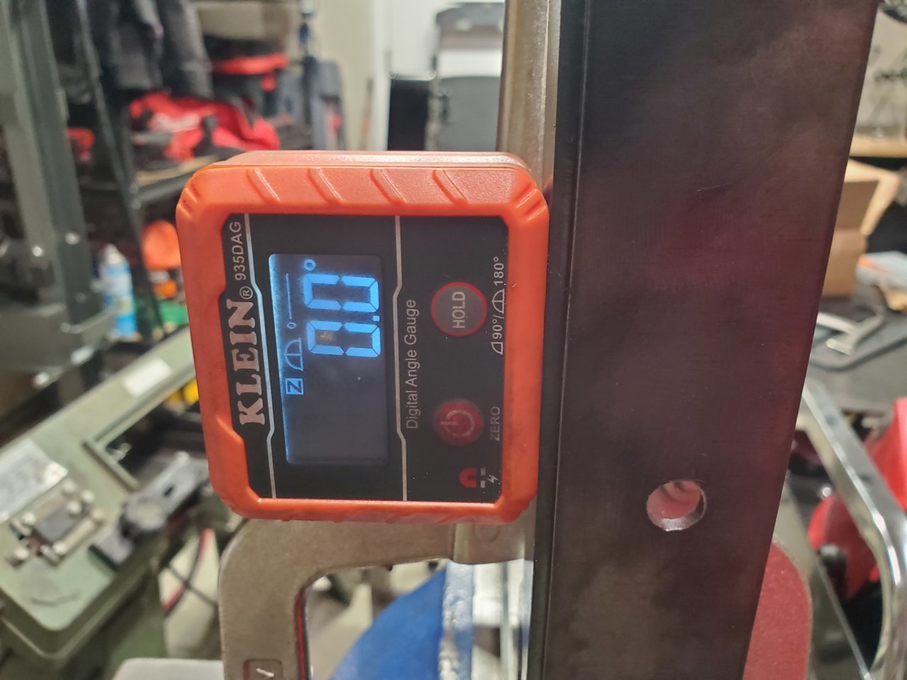

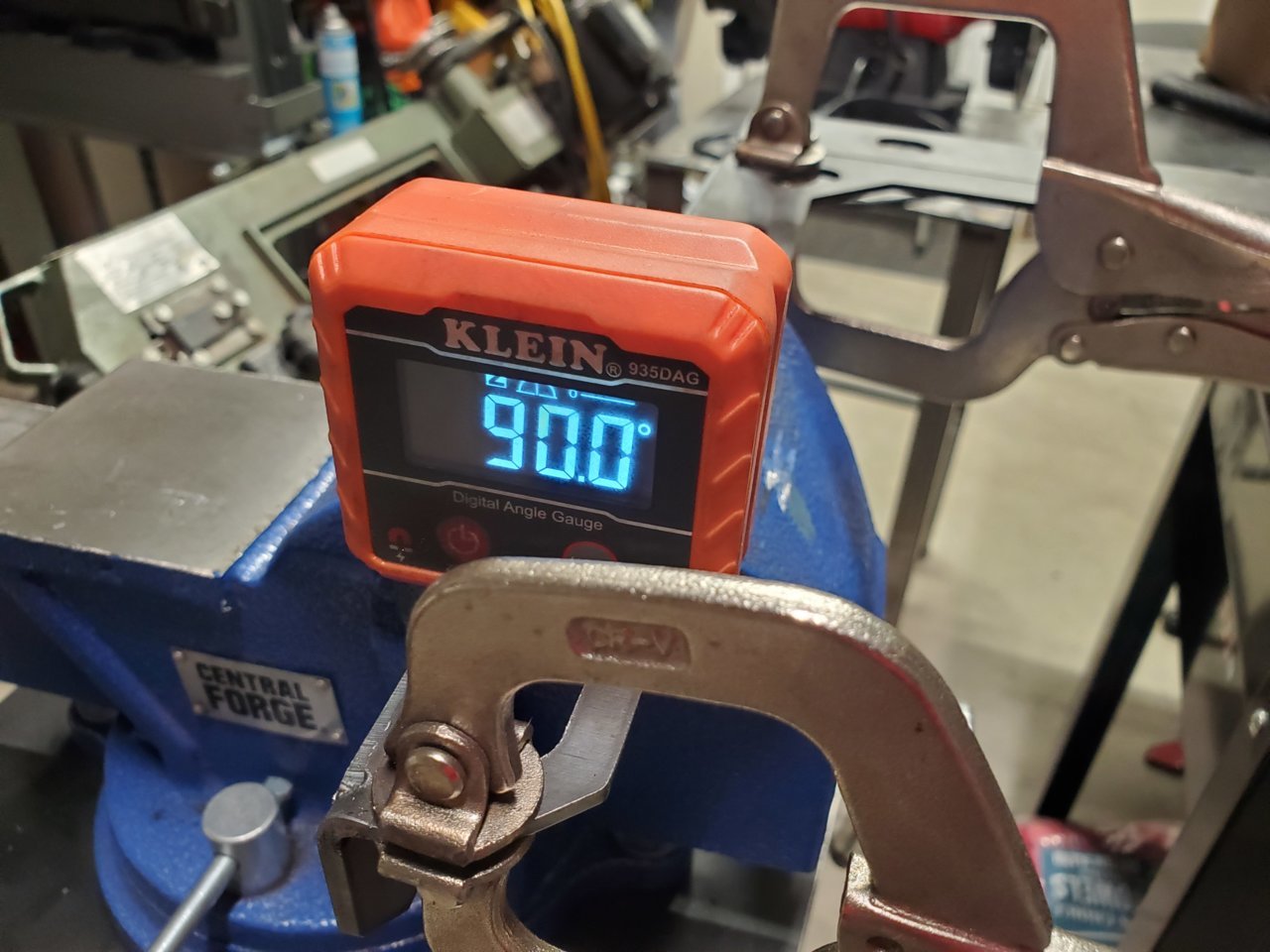

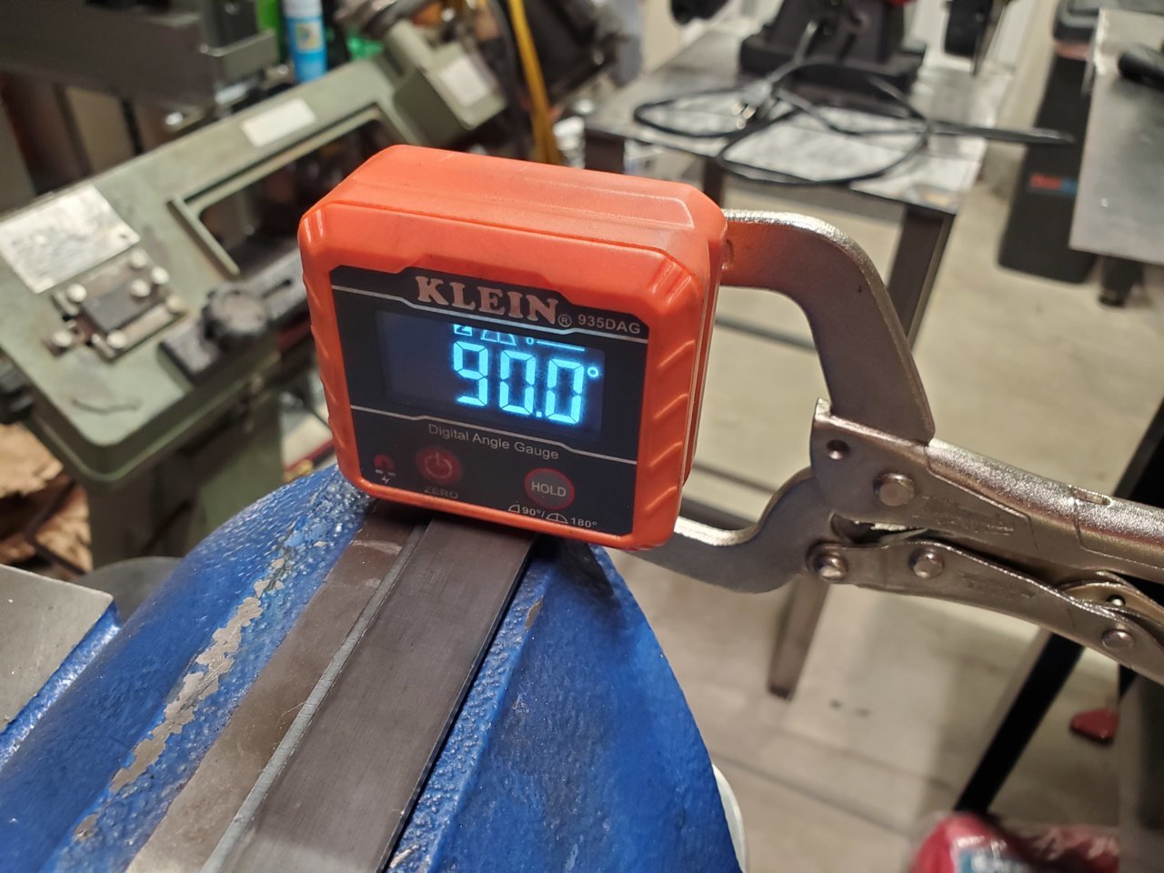

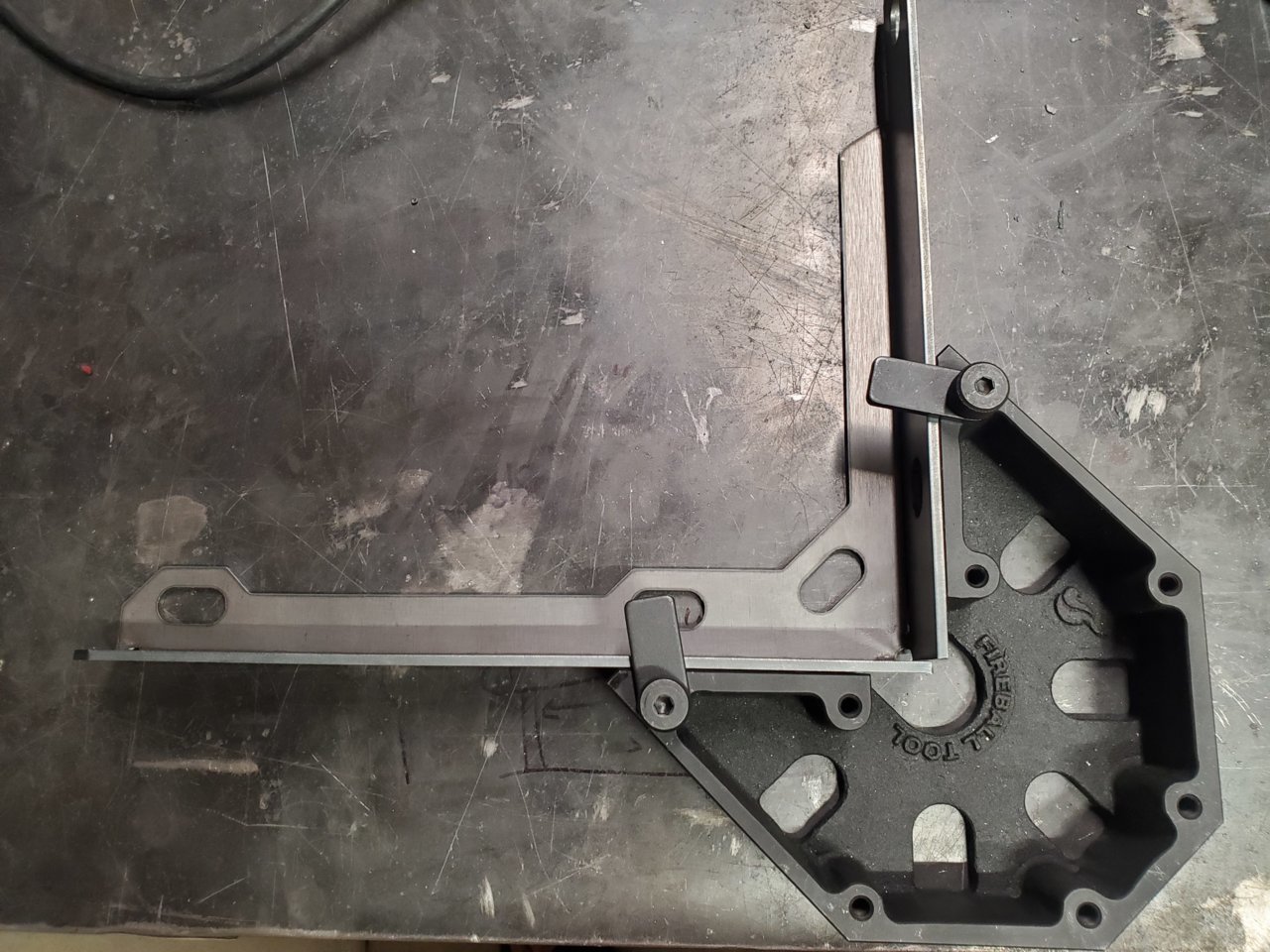

    Had a question recently both about bending and welding these up; not every weld-it-yourself set has been purchased by a seasoned welder so thought I'd chime in with a few helpful hints and pictures.
    To start, all you really need are some clamps, and a surface to attach your now-flat stiffener to.
    Even though I'm using a vise in the pictures, you can also clamp one leg to the edge of your welding table and bend downward until you achieve the appropriate angle ensuring both ends are 90 after bend back -
    Now it's ready to turn your piece, and rezero your angle finder -
    You can see that you do not need a press at all to achieve these bends due to the long relief cuts.
    Keep in mind, you will not bend each part in the same manner. You have a L orientation and a R; whatever way you bent your first part, bend the other in the opposite direction.

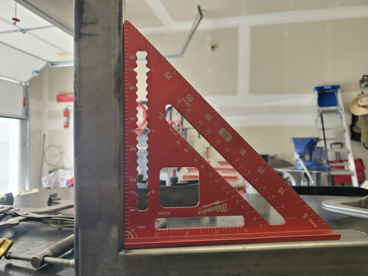

    Next up you want to make sure it is square -

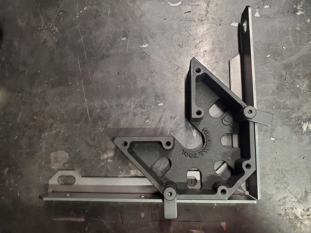

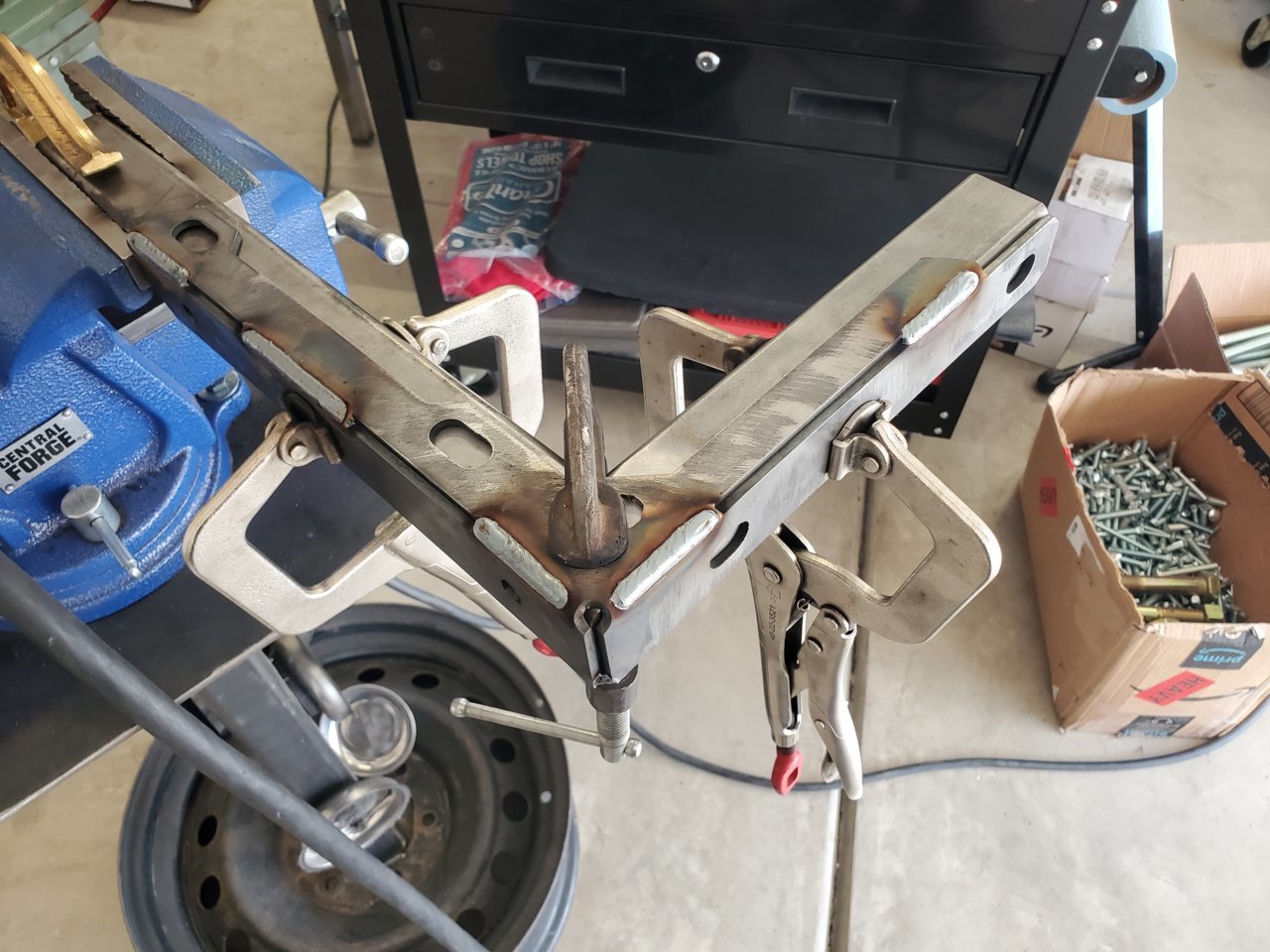

    For many that are just getting into welding, one thing you may have recently noticed is that your parts tend to warp after you're done welding. This is normal as the high heat causes expansion and contraction of your weld metal and base metal.
    Normally, you want to address this with a jig or clamp fixture and the best way to alleviate the issue is by applying a force opposing the direction of pull.
    Even then, a simple jig and the patience to allow a part to cool completely, will more than suffice in this situation.
    Here's an example of a quality tool/jig -
    However, a simple DIY setup is just as helpful to use as long as you've ensured it is square to begin with -

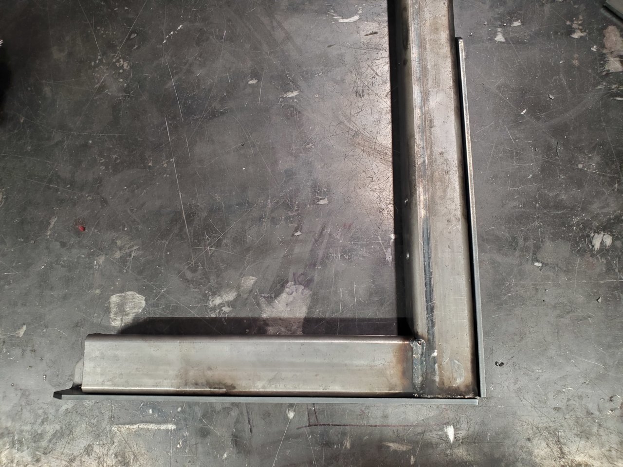

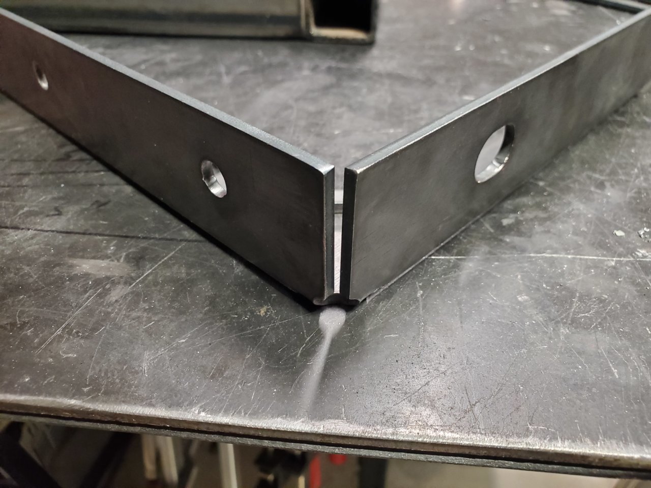

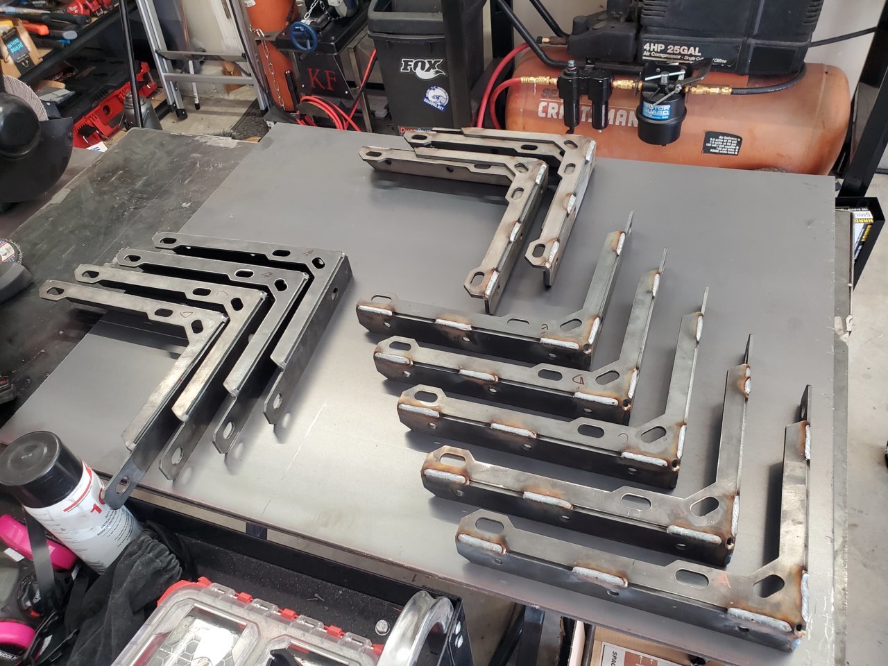

    Now that your parts are bent, and you have your jig ready, it is time for some welding.
    I normally advise placing a tack weld here as it will add rigidity in preventing deformation at the base of the legs -
    And although the relief cut spans near the entire length of the stiffener, it is not necessary to fully weld up -
    As shown below, I did some stitch welding with 1.5" length beads with approximately 2 1/2 " centers on one leg and maybe 4 1/2" centers on the other -
    MIG is by far the fastest and easiest method of welding, and if you choose to go this route I would suggest dialing in between your settings for 1/8" to 3/16". The open corner (depending on your experience) may lend you to use something closer to 1/8" as it can be easy to blow through the corner for a novice welder.
    If you are TIG welding, I suggest the use of filler rod again due to the open corner welding.

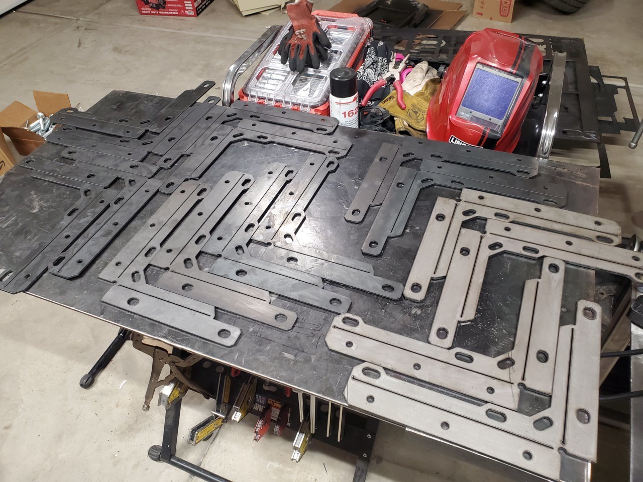

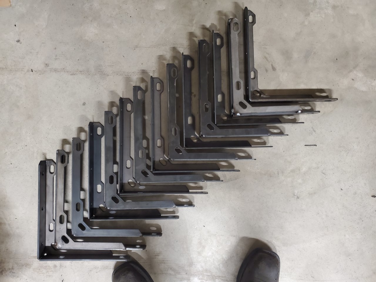

    Update, all parts cut!
    Wanted to add, I have 1 extra set cut out in 3/16" if anyone wants to go from 10 gauge to 3/16" (it is extra)
    I won't be cutting any more in this thickness as it is not necessary to have ;)

    What sucks is I'll have to cut another one out as I'm pretty sure I burned through it; I hit duty cycle on my welder as I was burning these in non-stop :laughing:
