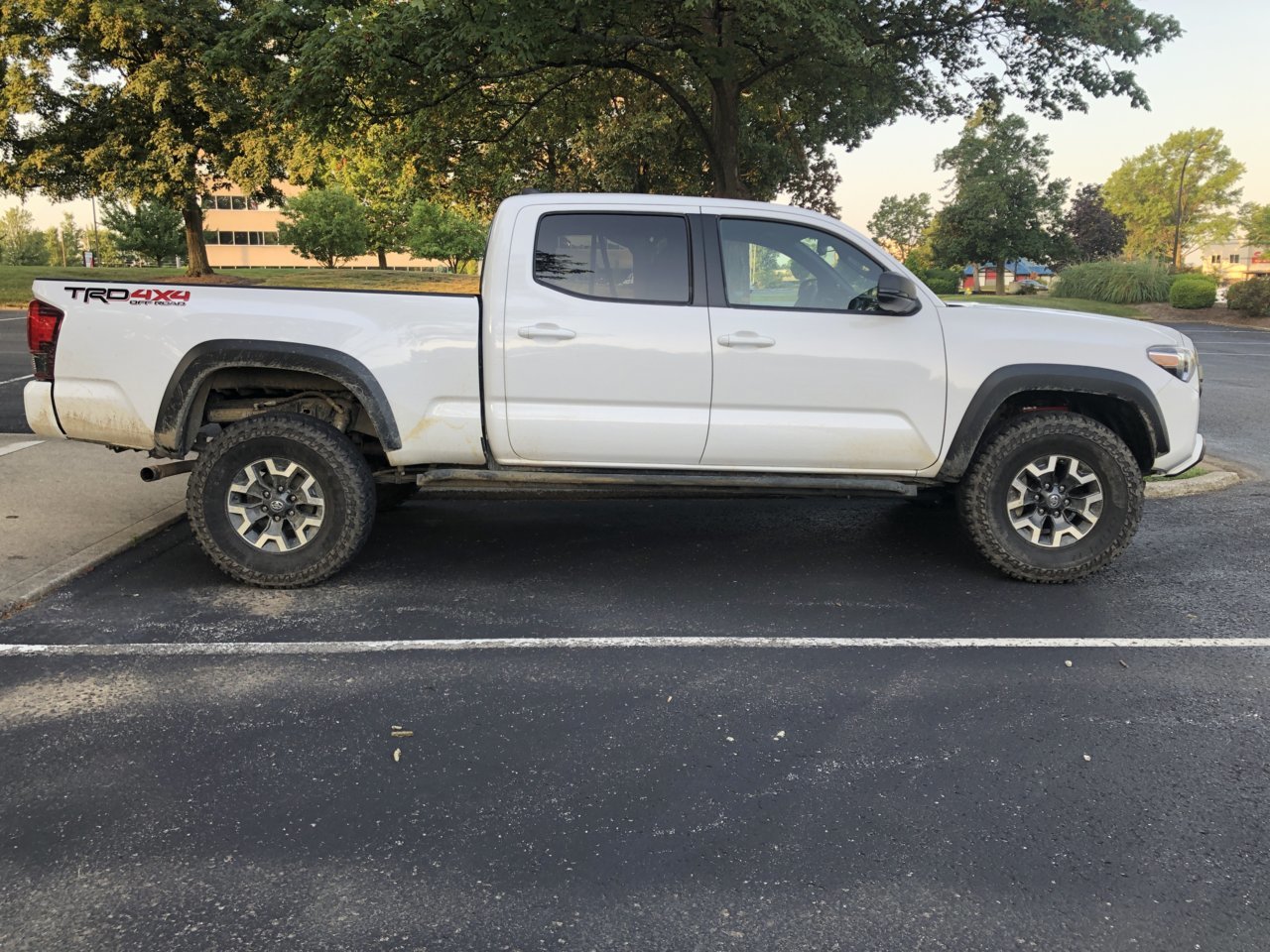

  13. Jul 24, 2019 at 5:21 PM
    #173
    rdpoe
    rdpoe [OP] #2WDFTW
    May 28, 2018
    #254789
    1,733
    Central Kentucky
    2019 TRD OR DCLB (Sold), Honda Civic TRD PRO
    Took it off and sending it back to ADS to get retrofitted with their new top out protection. Apparently they started shipping all their EXT coil overs with it this week. This and 700lb springs and should be back in time for Meat Sweats if I can get away.

  16. Jul 24, 2019 at 5:58 PM
    #176
    rdpoe
    rdpoe [OP] #2WDFTW
    May 28, 2018
    #254789
    1,733
    Central Kentucky
    Oh man, it’s embarrassing. The front looks like a Camry right now. I’m going to have to park with the front wheels on the curb at work so people don’t laugh
