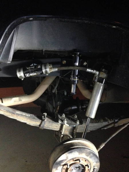

    I did barely tap the one installed the other day on the street on a decent bump. I heard it make noise, but didn't feel it at all, lol

    Locker test successful... and 4hi/4lo. W00t!
