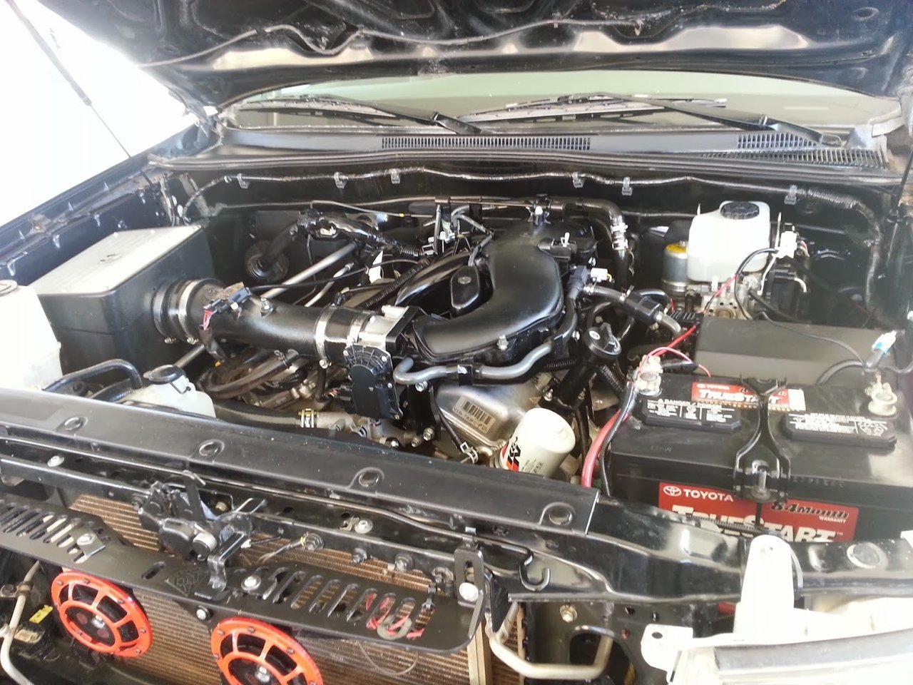

    So.... New tie rods (inner and outer), new remaned steering rack from Phoenix Rack and Axle, and steam cleaned the undercarriage and engine bay. Oh, and new bottle opener...

    Very Nice sir! Im likin that bottle opener ;)
    May have to look into that steam clean too.
