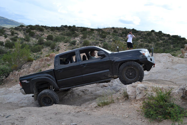

    How much cab mount you got chopped after that pic above? I need to take my sway bar off!
