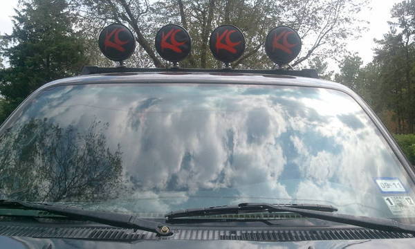

    I was wondering if replacing the regular h3 bulbs with led h3 bulbs would make an improvement in light output for my off-road lights, not that they aren't already bright. I just want to make them as bright as possible. HID's are to expensive to get right now.

    LEDs are more exspensive than HIDs (at least what I have seen).
    Also, LEDs are a poor choice in dusty conditions (ie night trailing with others or off road racing) because the suckers are SOOO bright and broad pattern, the dust particles reflect all that light back at you. HIDs in a pencil or driving beam will penetrate through the dust clouds a bit better.

    Oh, okay thanks! LEDs would cost about $45 for all four. HID kits would cost a little over $150... I'll just stick with the halogen bulbs for now though.

    Problem with LED's is the output is not focused at all, the light is very scattered. So in order for it to be of any use, you need a properly designed reflector

    Right now I have four 6 in. 100 watt KC Daylighters
    I'm just talking about an H3 L.E.D bulb, not a whole setup.

    Oh... that isn't at all what I thought you wanted... you said off road lights... not daytime running lamp bulbs (your link).
    Those bulbs won't light up the KC lamps and give you a beam of light a mile long, like the Daylighters do.
    Here is an LED off road lamp ($450):
    "The Brightest LED Headlight On The Market"
    LED (Light Emitting Diode) lighting has been around for years but is new to the offroad scene. Recent advances in technology have made it possible to produce high-output LEDs capable of reaching the performance and pricing of HID lighting. Baja Designs' revolutionary new forward lighting LED will set an even higher standard in high-performance off-road lighting.
    Weighing in at only 4 pounds 3 ounces the LED light features an arrangement of 18 LEDs which produce an incredibly smooth, even distribution of light. The light produces approximately 2880 lumens while consuming only 50 watts of power.
    Other Features Include:
    - 5000 Kelvin temperature for natural white color
    - Weighs only 4 pounds 3 ounces
    - Uparalleled vibration and shock resistance
    - Dimensions: 8.46" wide and 4.9" tall
    - Light mounts easily with one bolt
    - Easy wiring, only one hot and one ground to connect
    - Patented "Aim-N-Go" feature allows for tool-less light adjustment
    - Replaceable built-in rock guards protect anything you can throw at them
    - Rock guards also control the optics, which means you can easily go from one pattern to another.
