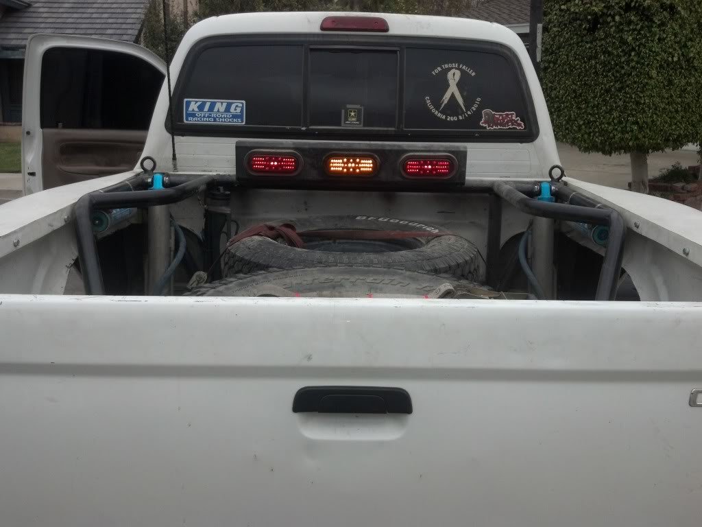

    If you swap out for a wider rear end, you can put your shocks outside the frame rails and keep almost all of your bed space. Also since you are in SoCal, there are plenty of shops and quality garage fabricators in the area that can build you a bedcage for a good price. Here's mine. Just need to sheet metal the wheel wells back in and I have virtually my entire bed.

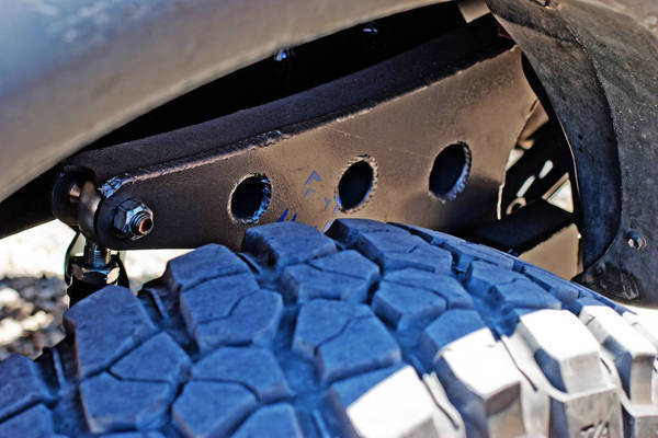

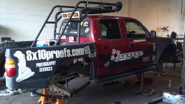

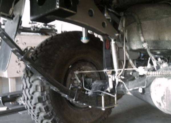

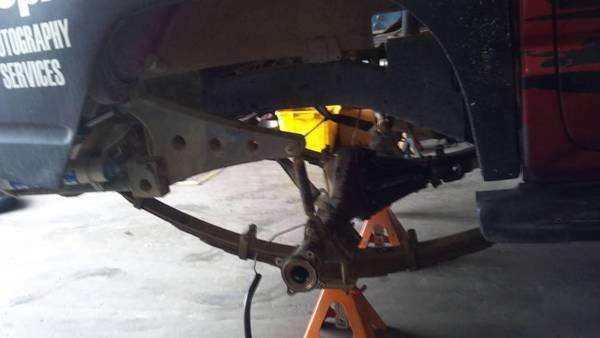

    if your looking for a cantilever system, here is what EngageOffRoad has to offer and also we can sell this as a complete kit, or a data file or a WIY (Weld It Yourself) Kit to save you significant $$$, if you are interested contact us here on TW ....Engage

    Please post some more pics, the ones you posted don't really show much of anything...
