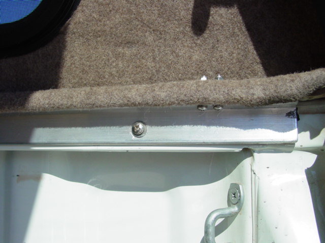

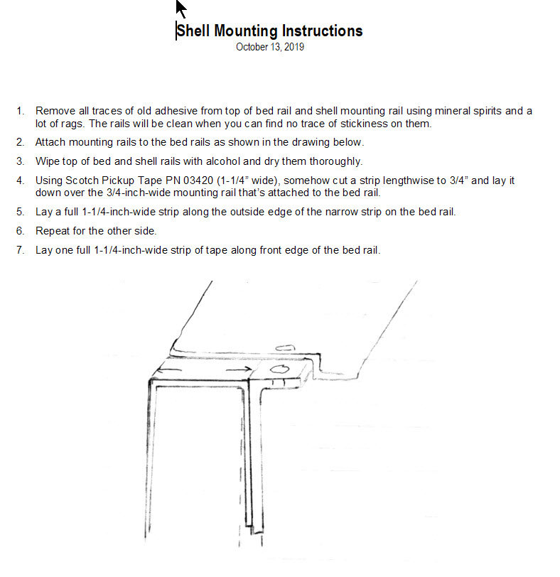

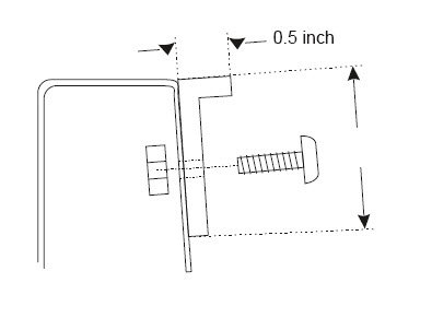

    I installed them years and years ago.
    I started with two aluminum L-rails and had the seller cut down one leg to 1/2 inch wide. Then I took them home and cut the length to fit the length of the truck's upper rail. Bought stainless steel nuts and screws and mounted the L-rails. I drilled four holes in the vertical surface of the truck bed rails and then installed the aluminum rails to the bed rail.
    Next, I put the mounting tape onto the bottom of the shell mounting surface, set the shell onto the bed of the truck, positioned it to where I wanted it, checked the door opening to make sure it would close properly, and then drilled four holes in each aluminum rail upwards through their horizontal surfaces and secured the shell with the nuts and screws.
    The vertical lip of the truck's bed rail is not perpendicular to the ground and when I mounted the rails, the horizontal surface was not parallel to the ground. Sobeit.
    Here's what I have in the way of illustrations:

    Interesting way to mount a Cap
