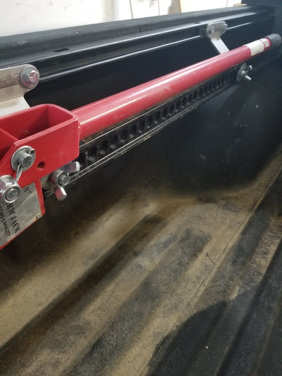

    I like the idea of using it to mount a Hi Lift to it. I was trying to figure out where to mount it, once I got mine.

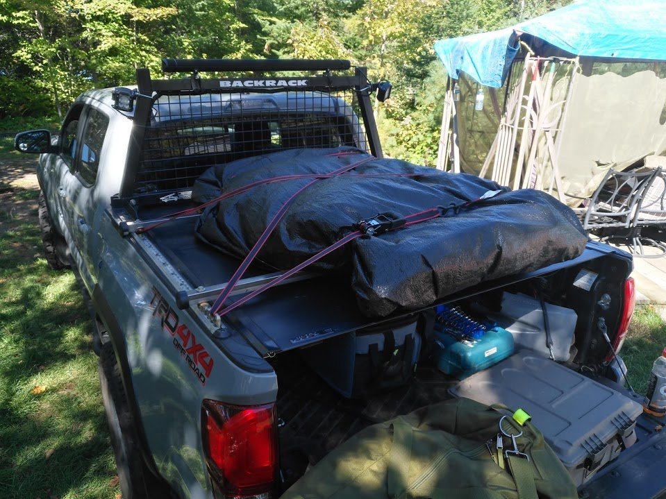

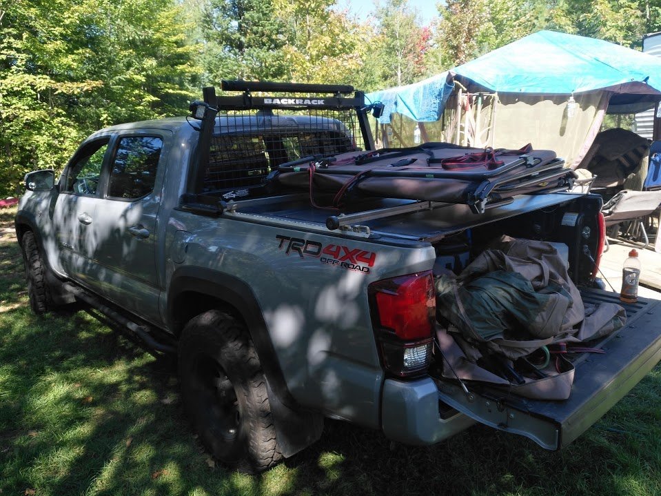

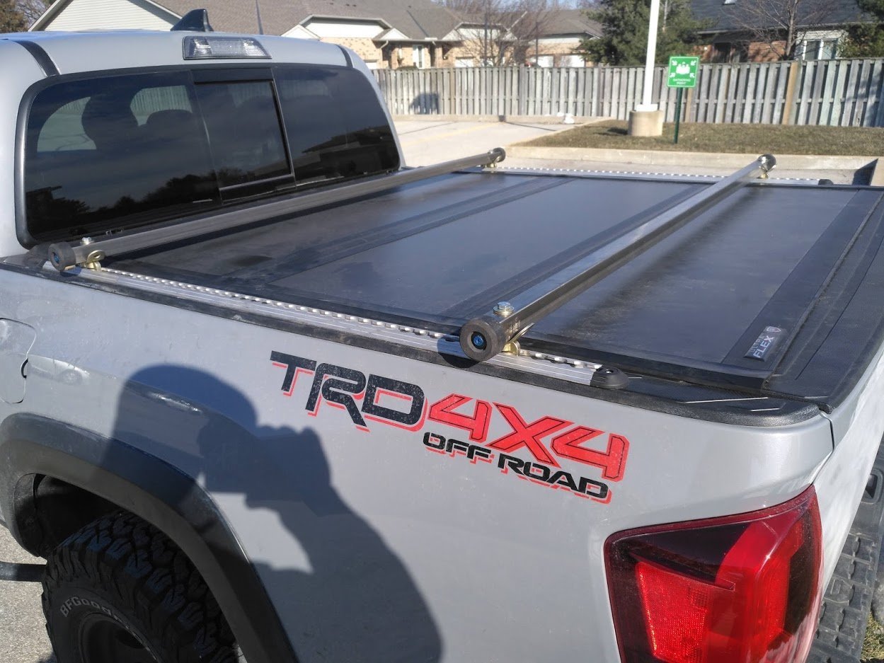

    oh boy, had i known this thread existed before... another member PM'd me about my L-track setup so figured i'd chip in.
    It's not 100% what the thread is looking for but the L-track system i have is not inside the bed rails but on top of the bed sides, but it might have some useful information for some people looking for something similar.
    I have a build log here;
    https://www.tacomaworld.com/threads...ack-low-profile-l-track.665324/#post-23321093
    and here is the TLDR post about adding it to a backrack/ headache rack;
    https://www.tacomaworld.com/threads...-3rd-gen-today.399305/page-8129#post-23527829
    I've had it on there full for about 8 months now, had come in as a very useful crossbar mount.

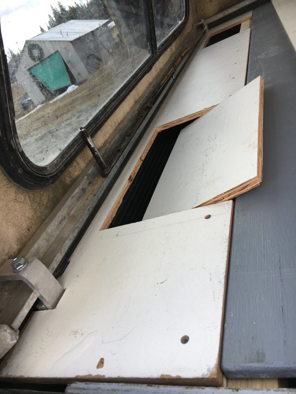

    I would have to measure the underside of the bed rail, might be able to back it up with some strap or angle. I will still do that for my rig as I do have the second gen channels on my bed rails. I did set up my platform side assemblies to key into the 2nd gen tie down channel: visible- barely under the topper rail:
