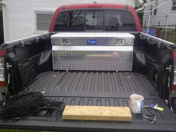

    People have mounted it in the truck bed but I haven't seen anyone swap factory rails with it. People have swapped factory rails for unistrut. If I really needed the extra tie down versatility sure but I don't.
    I have 2 lengths of "L/airline/O/whatever people want to call it" track mounted in my truck bed because it made more sense in my application to bolt things to the floor with this stuff than to the rails.

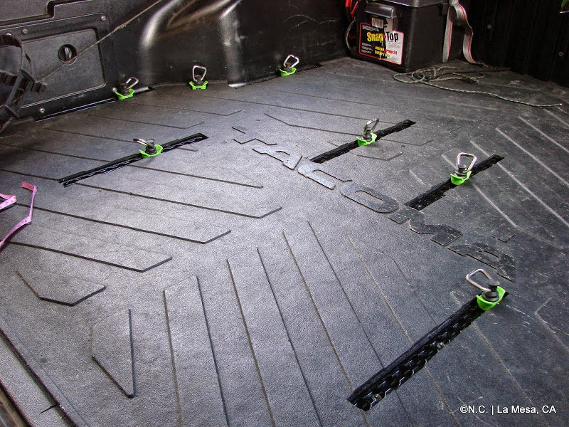

    Tomorrow I'll take delivery of two 4' sections of L-Track. I was not planning on replacing the stock bed rails with it, but I'll compare and see how the bolt holes line up. For what it's worth I have worked with the L-Track before, by cutting it to custom length, drilling and countersink holes. Because it's aluminum, it's really easy to cut and shape.

    It works for me, I plan on extending it and applying to the tailgate as well.

    ^ Very nice. (nice pics too!)
    I'm about half way done installing numerous 12" sections in the truck bed.
