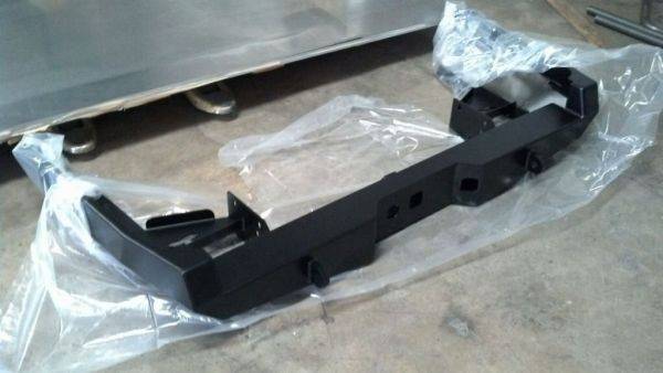

  19. Sep 13, 2013 at 2:10 PM
    #419
    la0d0g
    la0d0g [OP] Its 4 o’clock somewhere
    Jan 25, 2011
    #49903
    19,678
    running for the hills
    For crawling not hauling
    :spy: just need to find some time to get this mofo on!
