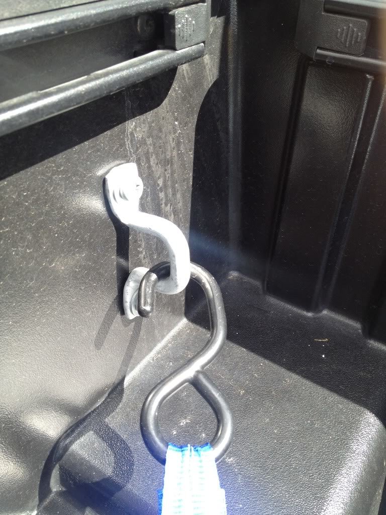

    In response to PM:
    These?
    62D5B6FE-0873-4AFC-8DCC-9F70B58D2923-218_2dfc13524f1a555aadb9df4c8ff5d2311b72f701.jpg
    If so, they came on the truck, but could be easily installed using heavy duty hardware mounted D hooks. Home depot should have all you need for a similar set-up.

    Thanks. Yeah, that's what I was talking about. I'm just wondering what type of hardware I should use to screw into the bedside. Some self-tapping screws I guess.

    Nah, I'd use something you can bolt from the rear, just line up the hooks, mark, and drill. If use 1 1/2", 1/4-5/16" threaded bolts.

    You'll want backing plates on the back of the bolts to keep the bed from cracking I think. Would be a 2 person install, one to tighten from inside the bed, one holding the nut inside the fender well

    I'm curious whats behind the stock ones. If they reinforced them at all or not. I would be worried about putting to much stress on them and ripping them out.

    Yep, me too. Only looking to hang about 10lb off of it so hopefully with some backing it'll be alright.

    They are reinforced with lock tight, larger washer and nut behind the tub

    Used washers on both sides, turned out super solid.

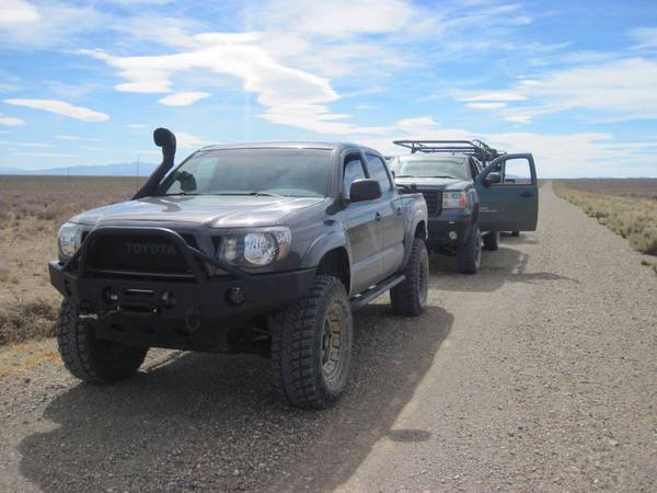

    Thought I would share some of my pics from my trip up to Knott Creek last week. We tried to stay off paved roads as much as possible and did a pretty good job. By the half way point of the trip I had racked up about 190 miles on dirt. Unfortunately the hub on our ranger trailer decided to grenade, so we had to disassemble and drive 60 miles back to Winnemucca to get a replacement. We got it back together but my buddy who was pulling it wanted to go paved and so it was mostly highway/freeway miles the rest of the way. As is every time, such a fun trip. I can't wait for our NV expo trip this May!

    Thats a lot of dirt!
    I think your buddies GMC needs some bumpers :p :D
