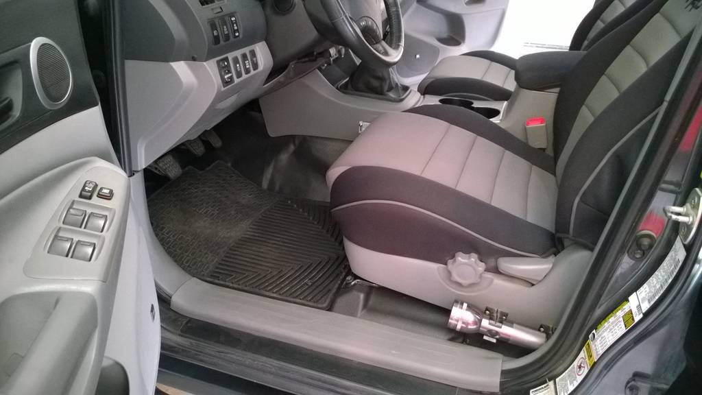

    I don't think I've seen anyone publish that part number. Weird thing with the vinyl flooring is that even the dealership doesn't seem to know whats going on when you ask them about it. I had to give them the part number and even then, when they read the description to me it sounded nothing like the product.

    I am very interested in this!! I am trying to find a part number for the access cab.

    I've heard about the vinyl/rubber flooring like the FJ's. That's pretty cool.

    It wasn't difficult just a little bit time consuming. I removed the bottom portion of the back seats first, followed by the front seats, then center console and all the other plastic pieces and kick panels. After all that is removed the carpet lifts right out. But by far the largest time consumer was cutting and putting in the dynamat. At almost $6 sq ft I wanted to make sure I used all of it that I bought.

    So 20 s/f? How many dynamat sheets is that. I used a few on my back panel and have two left so am wondering how many more I'd need to do the floor.

    There were five sheets in the box I bought.
    TRUNK KIT 20 sq.ft.
    5 shts 18" x 32" (1.85 sq. meters) ea.
    Part No. 19405
    I didn't have enough to do the area under the storage container under the back seats. I think I would have needed one more sheet to do that. I'll finish that when I do the headliner area.

    Curious why you're still using the Weathertechs if you have the vinyl flooring?

    Every vehicle I've owned with a manual transmission has ended up with a lot of wear in front of the clutch pedal. This was again proven to be the case two months ago when I realized I'd worn a hole through my weathertech mat. I know that in time I'd go through the vinyl too and since that's more expensive than a new mat I figure I'll just keep replacing those.

    Did your weather techs fit back in? I thought I read recently that someone that had bought a truck with the vinyl floor couldn't get his mats to fit correctly.

    I have the mats not the liners so they plop right down.
