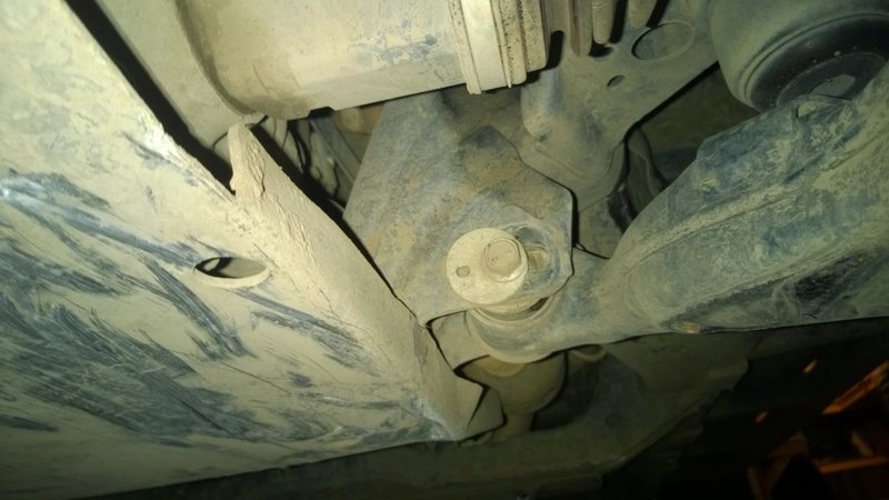

    How much of a pain in the arse is it to weld those tabs on? Mind you the only thing I've ever welded was my cab mount plates.

    Not sure. Dakotasyota said it was a pain but it looks the area is pretty much out in the open so it doesn't seem like the welding part would be that hard. I read a thread where they were complaining that the prep work getting the old shit off was a pain. :notsure:

    I found it easy. Hardest part is removing the old ones.
    Which I found easier to bend/mangle it up and get a cutoff wheel I there on the spot welds vs drilling the spot welds. 100 times faster method

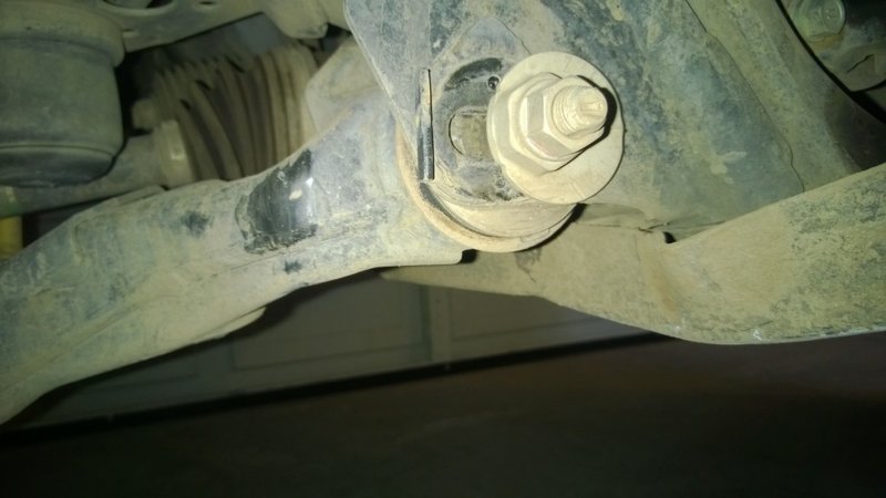

    Couple pics of the tabs or lack thereof.

    I think we charge like 4 hours to install those tabs. Takes a bit to get everything out of the way more than anything else. The welding portion is pretty straightforward.

    I thought getting them off was alright. I just drilled then used a hammer and chisel. Was a pain to get all the paint out of the way for my welds. The worst part was welding them, especially on the inside. I've been spoiled with a car lift and since that was in use it wasn't easy to get a good bead under there. Not enough room to get a good angle plus I don't have a welding apron so I got some nice holes in my clothes :anonymous:

    Get a wire wheel for your angle grinder. It removed the paint in that area like butter.

    Thanks for the info guys. Gonna place an order for some TCs tomorrow AM!
