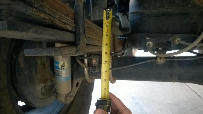

    Yeah the dakars are a bigger pack so you need slightly longer ones. I can measure them tonight if that would help you.

    Shitty pic but they're 9"

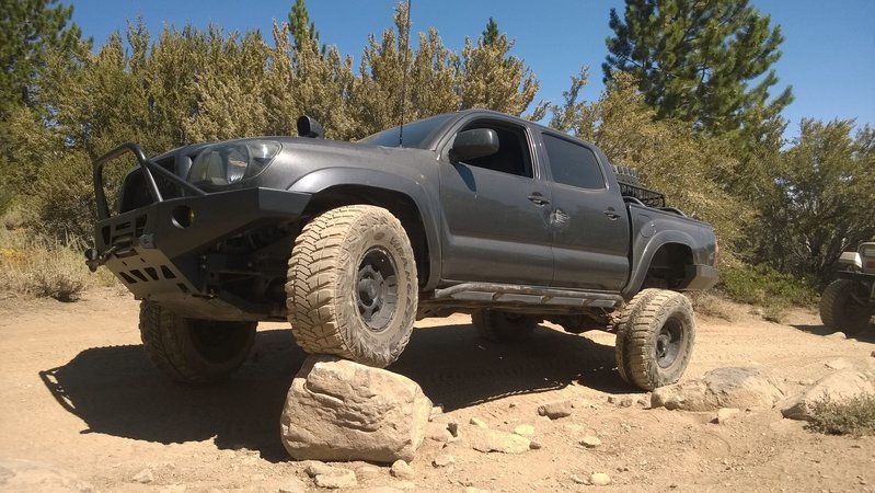

    I have shock extenders that got me about 2.5" more down travel.
    Decent droopz

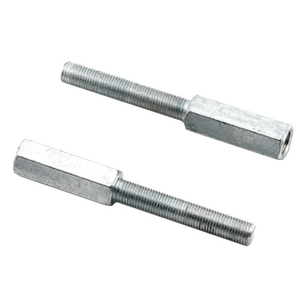

    They look like this. Screws on to the top. Cheap way to get more drop out of your shocks without affecting the ride.

  16. Sep 29, 2016 at 7:47 AM
    #1056
    Pirhett
    Pirhett Instagram @pirhett_ship
    Jan 29, 2015
    #147498
    5,219
    Rhett
    San Diego
    2014 TRD Sport 4x4 DCLB MGM
    Stock...
    oh snap never seen these clever little guys, they won't have the potential to weaken the original top screw and create the same effect spacers do on the original legs?
  17. Sep 29, 2016 at 8:38 AM
    #1057
    la0d0g
    la0d0g [OP] Its 4 o’clock somewhere
    Jan 25, 2011
    #49903
    19,922
    running for the hills
    For crawling not hauling
    Not that I'm aware of. Had them on for almost four years now without issues.
