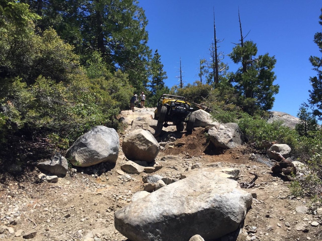

    For crawling not hauling
    Not great but you can see them

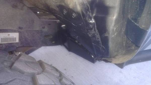

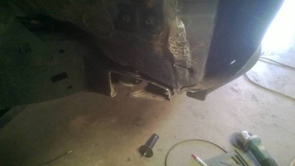

    Cut & broke off stuff. Prolific ziptie and tape usage.
    did you put a liner back in after cutting the fenders or just leave it open?
    I intended to which is why I left tabs on the fenders that I tucked up and out of the way but have never gotten around to it. Maybe one day when I get caught up on the mule build.
    I'm going to use heat malleable ABS when I do.

    ah, ok. I just messed with mine last night. Was hoping you found a better way. I didn't think to leave tabs when cutting but I still reused stock liner. Passenger side is ok but I don't like how driver turned out. Drilled some holes near fender opening and cut the stock liner to fit, then ziptied to the drilled holes. Flares hide the zipties.
