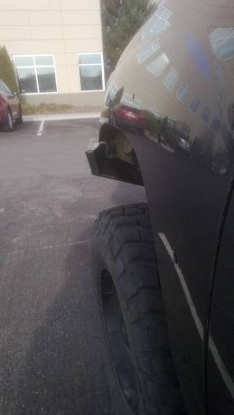

    Matt - here are a couple pics of the bumper and fender as requested. Sticks out quite a bit but as I said some of the bumper is getting hacked off.

    Thanks for the pictures. I actually like the look of no fenders but I don't think I could have it look like that (my bumper would stick out about the same), plus the headlight hoop on mine would make it look even further out.

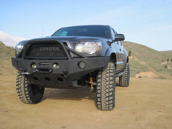

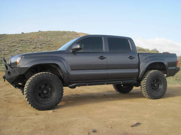

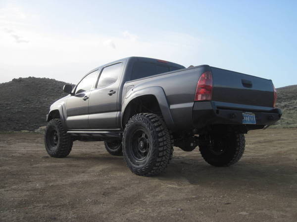

    Well the bumper got chopped and capped and the CMC completed on Friday (thanks Eric!). MTRs were mounted and balanced yesterday. I have a little bit of rub at full lock passenger in reverse and I think if I flex hard I'll rub the UCA so I might do some small spacer action on the front, time will tell. Overall I'm super happy with how it turned out.
    Rolled up to Peavine this morning to see how she felt. Oblig truck pr0n poser shots...

    Damn, :drool: I plan on doing this for 35s in the future. Loving the look :thumbsup:
    Got a couple of questions, did you cut the same off the front as the back flares? Looks like 3" on both, also what are your alignment numbers, mainly curious about the caster settings.

    Hard to tell by the angles but how close do the rears get to the front of the wheel well when stuffed?

    I cut out 2" from both the fender and fender flares. I didn't take home the number sheet and can't remember them. They were all in the 'green' though. Doesn't really matter since I need to get them f'd with again anyway. Next time I'll get the numbers for reference.
    :cheers: About 2" from the front of the well.
