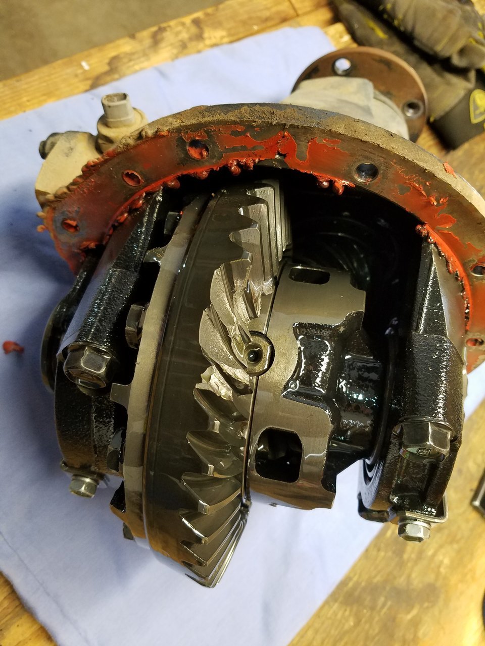

    Well I guess that was the noise I was hearing.

    You got a toof problem...

    Yep. That thing had maybe 8k on it. I need to go look at my maintenance book.

    8k no bueno

    OUCH! Is it just me, or does it look like the teeth have strange wear pattern. They look really rough/scratched like they were installed incorrectly? Was that an ECGS third?

    The intact teeth look good to me but I'm no expert. Yes ECGS, third third :)

    my god, 3rd third? I changed the oil in my 4runner ECGS built diff a few months ago after probably 3k miles and there was a concerning amount of metal filings in it, IMO. Oil looked metallic, had a silver sparkle to it. I need to drain and check it again.
    Might have Nates precision re-do that for you, unless ECGS is going to warranty it. We had Nate do brittony's new Taco last week, did good work for us at a reasonable price.

    My oil looked like some shit from a bad rave. I'll hit you up for contact info if EGGS isn't going to take care of it. I'll know tomorrow. :)

    They're covering some of the cost so it's in the mail back to ECGS. Now the waiting game :playball:

    Any word on the 3rd?

    It's back in. Just did the 500 mile oil change today.
