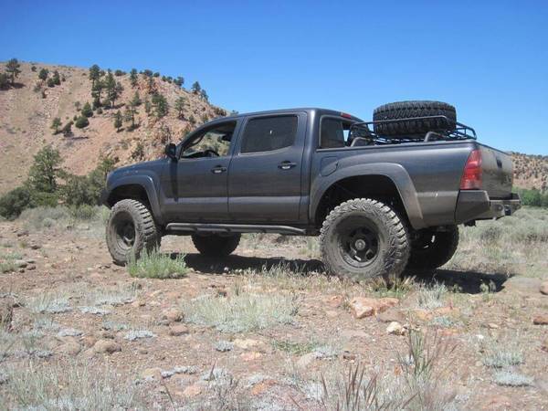

    Added some bed bars and Yak basket to get my spare out of the bed when I go camping. I need to take the bars off and paint them this weekend. I like how it turned out.

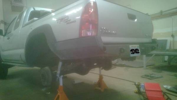

    Hooked up with Max this weekend and we swapped out our gears. My 3.73s for his 4.56s. Getting my CVs out was a total PITA but finally the bigger hammer method prevailed. Much thanks to Max, Colt, and Jared for making it happen and showing me WTF was up!
    Truck is back to having some pep in its step!
    Only took two shitty pics after we finished the rears.

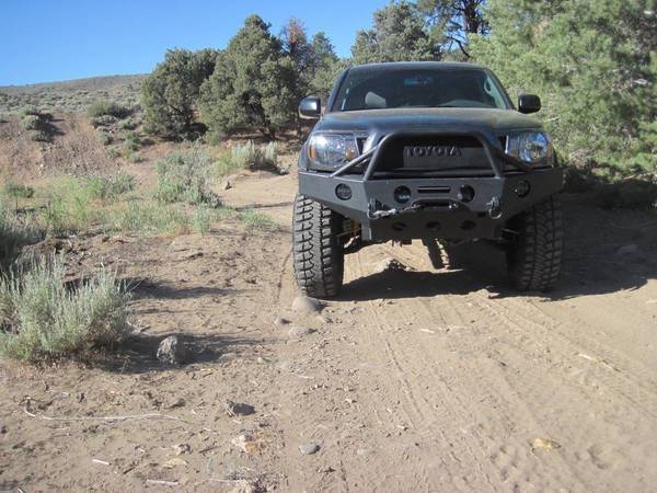

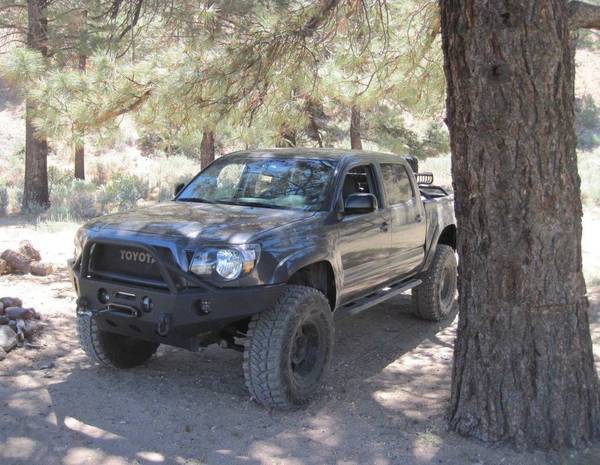

    Went out with a couple of friends this weekend for some camping and light wheeling on the Carson River. Weather wasn't as bad as I thought it was going to be and the temperature didn't seem to get as high as they were predicting. Even caught a couple rainbows while we were out, good times!
    On the way in, there are some trenches off to the side of the trail and I hit them up to test my flex and rubbing. Only rubbed noticeably during one section and I think it was against the top of the passenger side front wheel well. It was short lived and felt/sounded fairly benign. I should have gotten out and checked where it was hitting but it had been a long day and I was eager to get to the site and have a cold beer.

    Make sure you folded over the small pinch weld up in that front top area. That's where mine hit. The weld folds over easily, and will leave just the smooth part of the well for the tire to hit.
