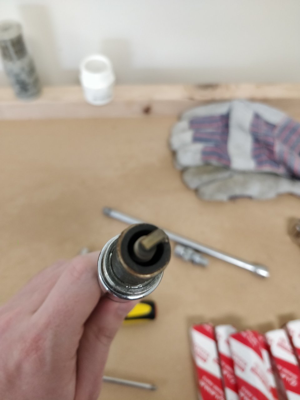

    I changed my spark plugs this morning, slightly past 30k. I'm glad I did, three of the six plugs were loose. I've never seen that before... Anyway so I change the plugs and when I put the new ones in I torqued them hand firm. My torque wrench is 1/2 drive so the plan was to go to town and get an adapter so that way I could actually torque them to 15 foot pounds.

    (Also in case anyone was curious, I attached a photo of one of the old plugs)
