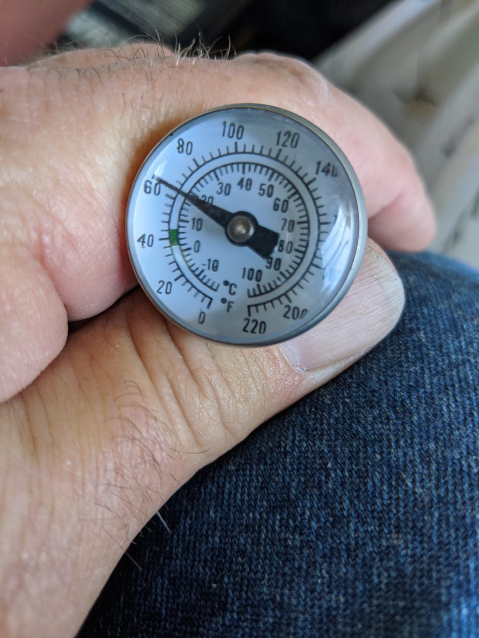

    I've used my AC a couple times and it's gets this thermometer below the green. I did replace the expansion valve last summer, so I have a fresh charge.
    The day I charged the system, it was in the 90s and I remember the high side being over 300.
    I used a chart along with a scale... Let me see if I can find it.
    Eye'll be Bach...
    Post #33.
    https://www.tacomaworld.com/threads/not-so-cold-a-c.613682/page-2
    Yaaaas a pic of the thermometer would have been nice when posted.
