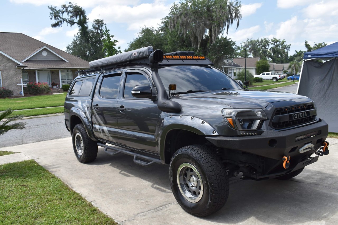

    Pop that hood up 1/4'' and it will be even better, see hotboi below. That plus good quality tint will make a big difference.
    Hotboi
