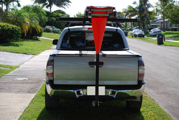

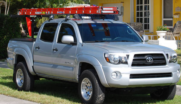

    If you already have your roof rack on then you may want to consider my setup.
    I also carry a Werner 32 and 16 footer. I use a Thule roof rack in combination with an Extend a hitch on my receiver hitch. The extend a hitch goes for about $95 at Northern tool. I also use a hitch rider anti rattle vise clamp (http://hitchrider.com/) on the extend a hitch to keep it SOLID with no wiggle or play.
    I travel several thousand miles a month all over the South and Midwest with this setup with no problems. When I don't need to carry my ladders I can easily remove the Extend a Hitch in seconds. I am loving it!

    I like the trac rac setup a lot...but unfortunately, it would not allow me the use of my roll n lock cover. That's why I went with the Thule and Extend a Hitch.
    The Thule is rated for 150lbs but when used in combination with the Extend a Hitch you can carry 300lb total and I get to lock my bed as a bonus.

    Great pics. Thanks for posting them. Your setup looks very good. I'll file this for future reference.
    Thanks for the Trac Rac idea too. Nice to know it's out there.
