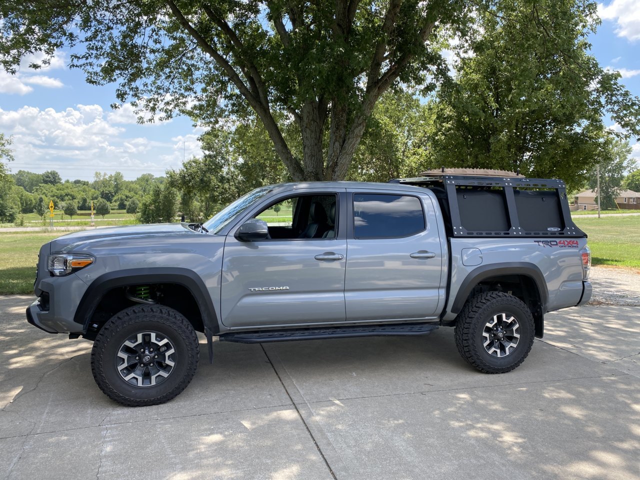

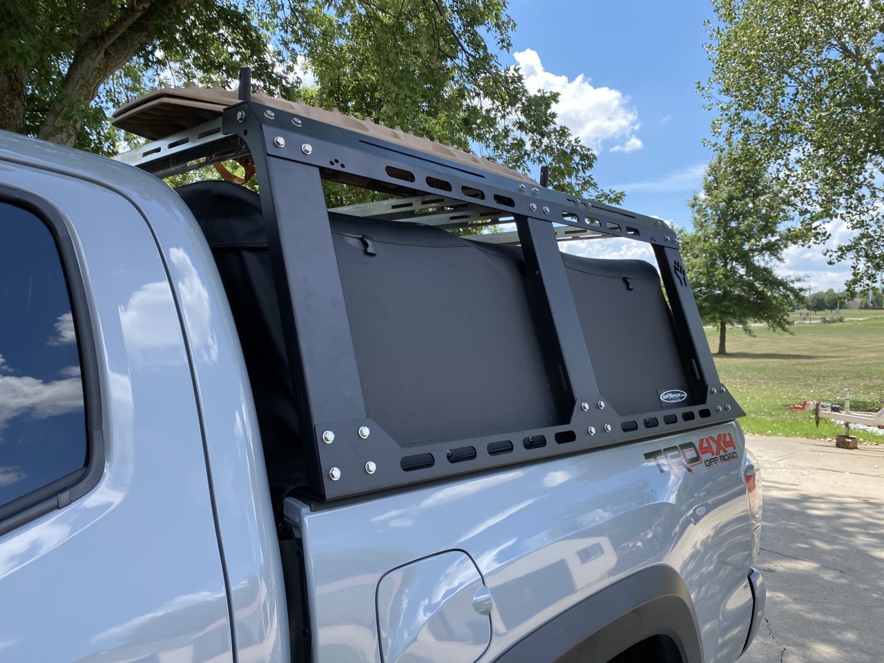

    Does it need to go over the cab? I have the Dissent Off Road bed rack, used it for my ladders, transporting lumber, and my camping needs (awning, maxtrax, kayak). It’s all aluminum and weighs about 45 lbs.
    CF88BC6D-9715-43F1-BB19-FB2D588767DA.jpg 1A8C2588-5E01-49CA-818C-F862E2D6B1F0.jpg

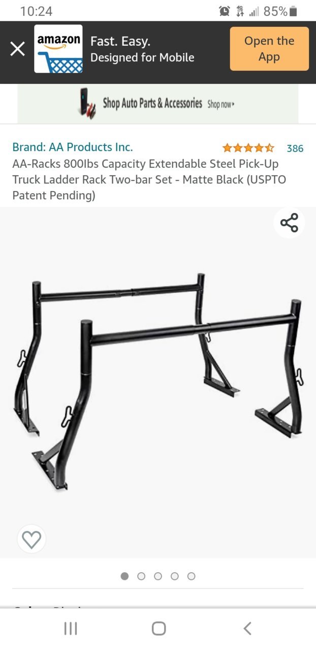

    Thinking about these because they came with c clamps so you can put them on when needed.

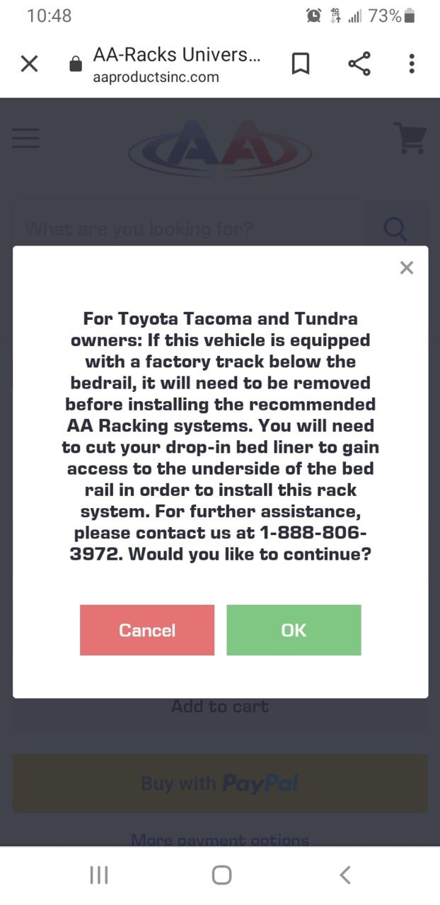

    Not to sure about this though.

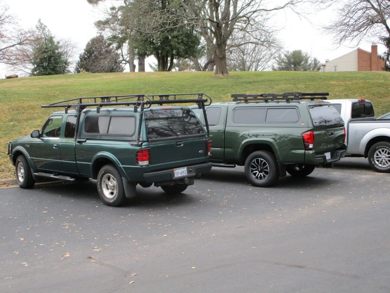

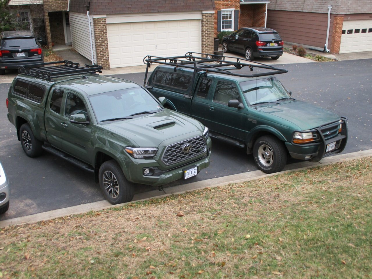

    Compare the racks on my new Tacoma versus my old Ford Ranger: a Prinsu rack versus a Kargo Master ladder rack.
    Notice that the Kargo Master extends over the cab, and is attached by posts to the top of the bed. A similar arrangement would not have worked on the Tacoma, because the Leer cap covers (overlaps) the top of the bed. Kargo Master makes a version that attaches to the tracks on the cap, but the cantilevered weight over the cab would have put too much stress on the tracks and cap. So I was more or less forced to go with the Prinsu. To make it strictly equivalent, I would have had to add a Prinsu cab rack as well. That would have made the total cost of the Prinsu more than twice that of the Kargo Master. (Besides that, I would have had to drill holes in the roof of my new Tacoma, which I didn't want to do.)
