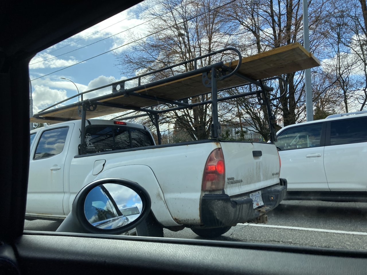

  5. May 10, 2023 at 2:43 PM
    Bivouac
    Bivouac Well-Known Member
    Sep 5, 2021
    #376253
    11,579
    Northern Lehigh Valley Pa
    2000 Tacoma 5 speed 3.4
    Remains to be seen I bought the tires and wheels the rest came along
    If you dead set about drilling holes i would look into building a Rack that sits in the bed on the floor .
    You can then ratchet strap it to the tie downs on the front and rear of the bed corners .
    This would allow you to design things as you need or change things as the need arises. The bottom support can be adjusted to spread out the weight as needed . Depending on the total load you need to carry.
    Would you be loading pallets from the rear?? Simple to make the rear cross piece simple to remove .
    This was the only option in a job no holes were wanted.
    Loads supported by the side of the bed tend to spread the bed apart if serious weight is carried.
    Good luck.
