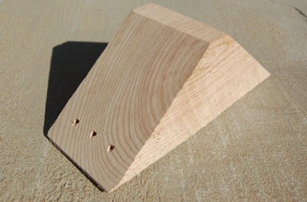

    How about a standard (matching) size spare, and two custom-cut wooden wedges, made from 4x6 or 6x6 stock.
    Once the truck is jacked up and the tire is 1/2" to 1" off the ground, put a wooden wedge on either side of the tire to be changed. The wedges will support the weight of the tire when it is pulled off the lugs.
    For putting the spare on, remove one wedge, roll the tire into approximate position, then put the wedge back and "walk" the tire up the 2 wedges and forward onto the lugs. (Moving the two wedges to bring them slightly closer together as the tire is rolled back and forth between them, which will raise the tire in very small & easy increments of maybe 1/8" or so.)
    Practice 6 or 8 times on a flat parking lot or driveway somewhere to get the hang of it.
