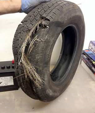

    I meant I don't think there is a significant risk of the tire blowing at that speed. The belts in that tire should have no problem at all holding the tire together at those speeds, even if one or two of the belts was cut by the bolt.
    He brings up a good point, though. I'd for sure put that tire in the rear, or better yet, use it as a spare.

    That is a completely false statement, a tubeless tire can and will blowout. Here is the example. He plugs the tire, he’s driving down the highway at speed, the tire looses enough to still drive but the sidewalls actually at this pint due to low pressure overheat and breakdown, two things happen the tire will literally shred apart and you have time to pull over or the sidewalk will blowout at speed. Having worked on tires I’ve seen many examples of both.

    This was caused by belt separation, no puncture. In the rear, or as a spare is the best advice yet.

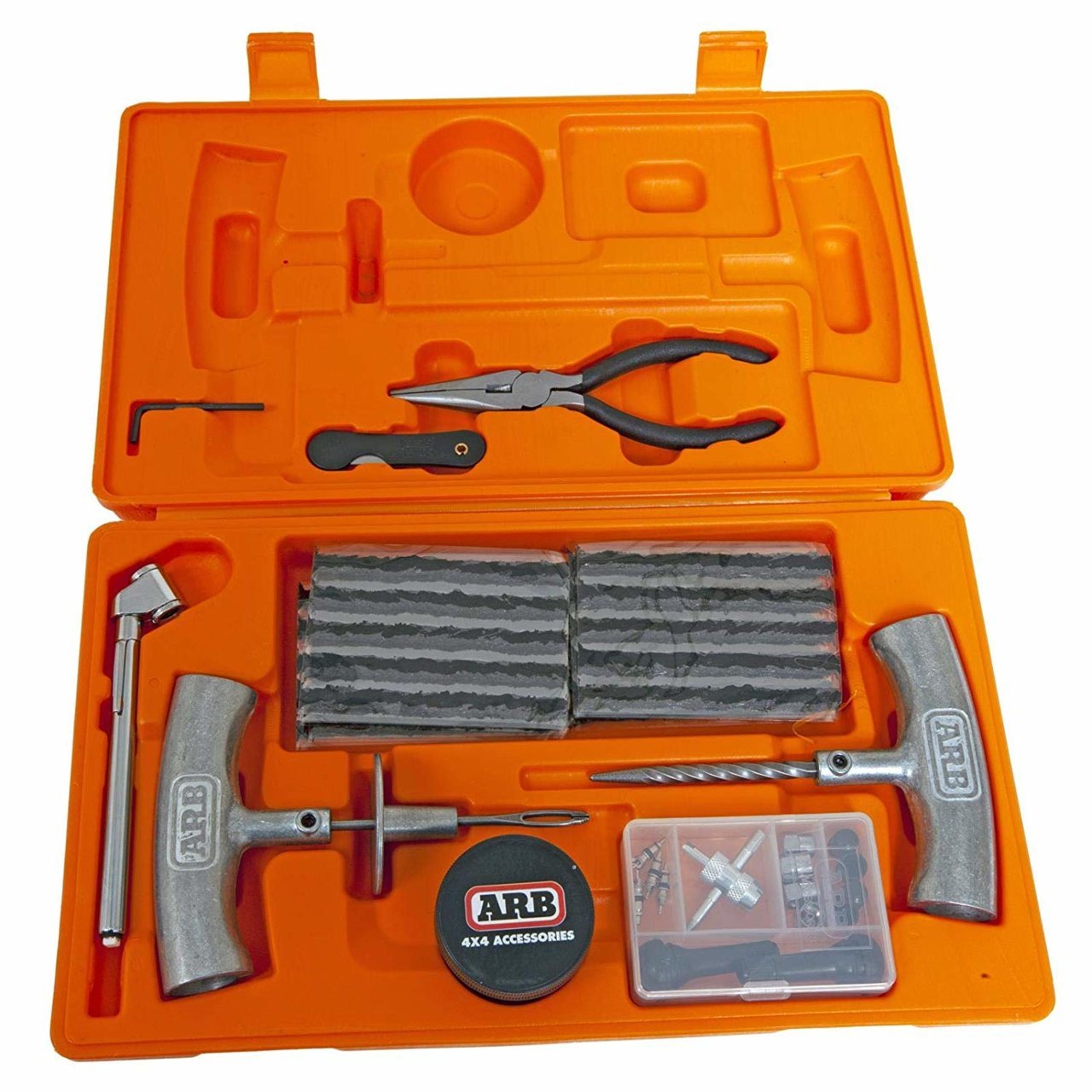

    ToyotaJim; the plug patch is the best, for sure, but a plug would fix it pretty well, and you don't need to dis-mount the tire. ARB sells a very-good tire plug kit (photo attached), and I always keep one in my truck, and have used it dozens of times. I have NEVER had a plug leak or fail. Additionally, it looks like your lag screw went straight in, not at some crazy angle.
    Plugs are basically made of a synthetic rope (strong fibers) impregnated with un-cured rubber. When you put the rubber cement on the rubber-impregnated plug, and then push it into the CLEANED puncture hole, it will actually vulcanize the damaged tire back into a homogenous unit; just like it was before the screw went into it. And, be certain to push the plug well into the inside of the tire (1/4" - 1/2") before cutting it off; this allows the pressure inside of the tire to "push back" on the plug (towards the outside of the tire) to further seal the puncture; kind of a "half-assed" boot/patch on inside of the tire. The pressure inside of the tire causes the inner portion of the plug to flatten out on the inside.
    Remember though, after you have inserted the rubber cement-impregnated plug, be sure to let it sit for some time to cure/vulcanize before re-inflating to full pressure.
    The reason I emphasize both cleaning the puncture and using a generous amount of rubber cement on the plug is because I have actually seen guys complain that a plug didn't hold, only to find out that not only did they not CLEAN the puncture, they didn't even apply ANY rubber cement (kind of the glue) to the plug before inserting it!
    I always plug a tire that has SOME air in it, so that when you DO fill the tire back up, it doesn't stretch at the repair so much. Keep in mind, a plug works best in a ROUND puncture, and you should evaluate each puncture on the amount of damage that was caused. If the damage to the tire isn't a round puncture, then you will have trouble getting it to seal (and be safe).
    A little background on me: In another life, I ran a large company's (Goodyear) private truck/company car fleet, and was responsible for 39 tractor-trailer rigs, and 65 company cars. Even though we actually worked for a Tire Manufacturer, we plugged tires DAILY, and never had one fail; ever. Of course, we didn't plug tires that after evaluation were determined to be unsafe for plugging.
