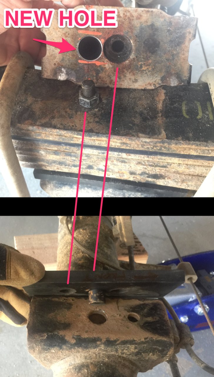

    Hmm I didn't even consider the bumpstops moving with the relocation plates. I actually have some durobumps that I was gonna install at the same time. Hopefully it isn't too much of a pain in the ass...

    I didn't consider it either, but I was lucky that I was at my friends place that had a drill press and step bit that I could just NOM NOM NOM into the OEM bumpstops and make it work.
    Send me or post a photo of the bottom of those durabumps and I'll tell you if you'll have a headache in the future...

    Yep, you'll have a headache. Since the square u-bolts site in the same position BUT you'll be moving the leaf springs, the top of the bolt holding the leaf pack together will want to go into a hole that doesn't exist... Here's what I did: aligned the relocation plate to the bumpstop and marked where the 3/4" relocation hole was on each bump stop. Then I drilled. Walked over and tested if my hole was big enough, went back to the drill press and went to the next step. Repeat until new hole in bump stop fits over bolt. If you're going to be replacing the leaf springs soon, I'd probably wait on installing the durabumps in the rear to not drill them since it seems like it's only the OME Dakar leaf springs that put our axles in the wrong spot... Likely your new Alcan (guessing) leaf pack will be positioned correctly and you can install the durabumps and remove the axle relocation plate.

    Ignore that in my photo compilation I am showing the 1" relocation hole being used. I actually rotated the plate and used the 3/4" hole (which I'd recommend you use). 3/4" is almost too much relocation for my truck with 32's and I think 1/2" relocation would have been ideal for me. Oh well.

    Well that's annoying... Maybe I'll just not use the relocation plate. The worst rubbing I get is the tire on the hex head screws that hold the flare on. I might try replacing those with some pan head ones that have a shorter head, or just remove the ones that rub. Got some thinking to do, I guess...
