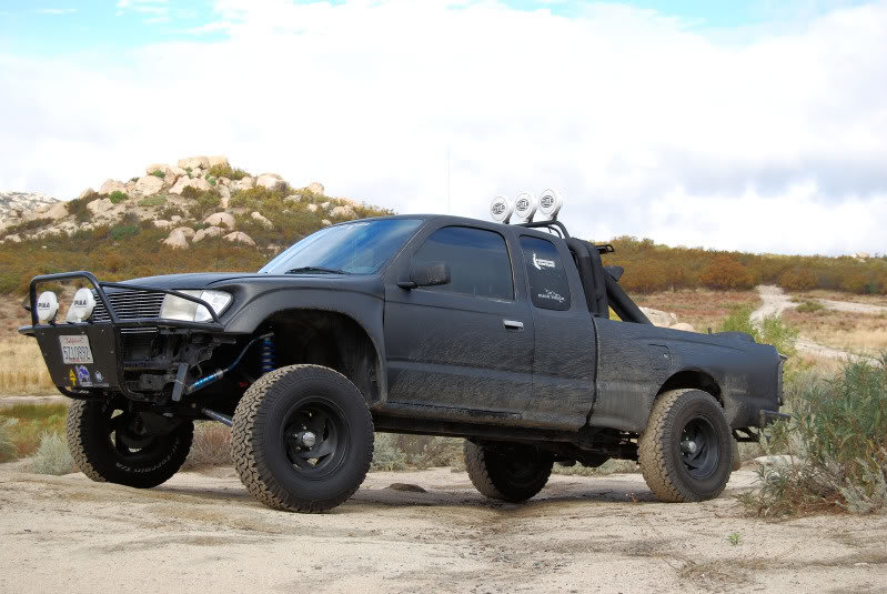

  10. Feb 22, 2012 at 4:03 PM
    #50
    Siebler
    Siebler Duck Killing Machine
    May 9, 2009
    #17019
    820
    CJ
    Portland, OR
    99 Long Travel 5 lug, 01 Tundra 4wd
    TC LT Front, F67 on 12" shackle, LCE Underdrive Pulley, Flex-a-lite fan, DT headers, Super 44 muffler, 4:11's and Aussie Locker, 22 Gallon Fuel Cell, Beard seats, sliders, bed cage

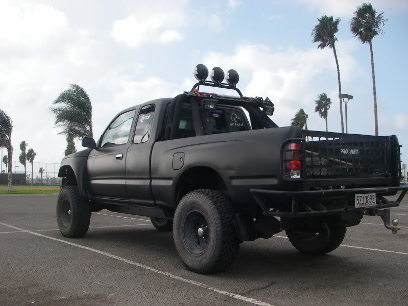

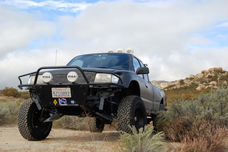

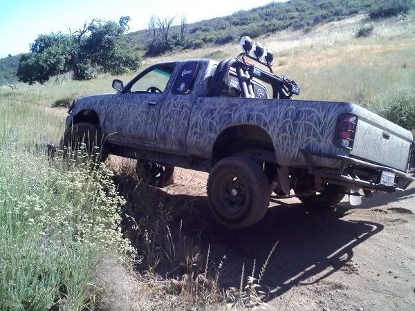

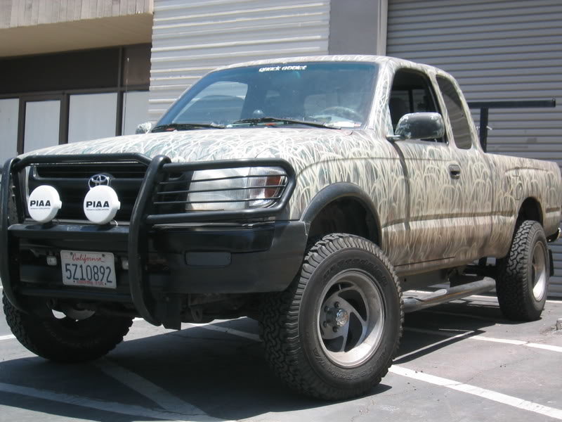

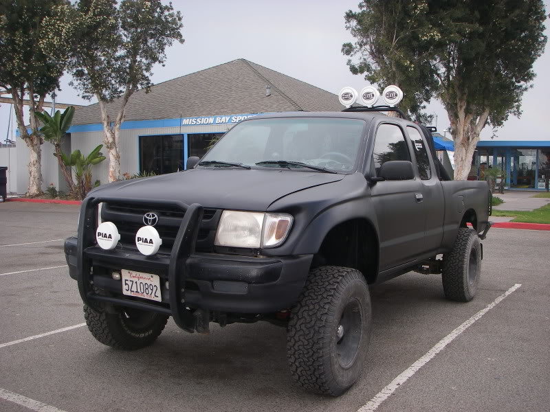

    Find spindles for it if you want to lift it. Dont even play with spacers/coils/arms unless your going to go LT and eliminate the Lower BJ bracket. This is the weak point in 5 lug suspension and they DO break (3 times for me to go LT).
    Nothing wrong with a 5-lug, I love mine. Loved it when it was slightly lifted and still love it as a full LT truck.
    That Stepside would like BITCHIN dropped though, they always do.....
    Evolution of my 5 lugger in no real order just ideas on what can be done....

  12. Feb 22, 2012 at 4:37 PM
    #52
    Siebler
    May 9, 2009
    #17019
    820
    CJ
    Portland, OR
    The potential for breaking is the Lower BJ and BJ Bracket. Eventually somebody will make a machined piece to replace it but for now, they are like 45 bucks and suck.
