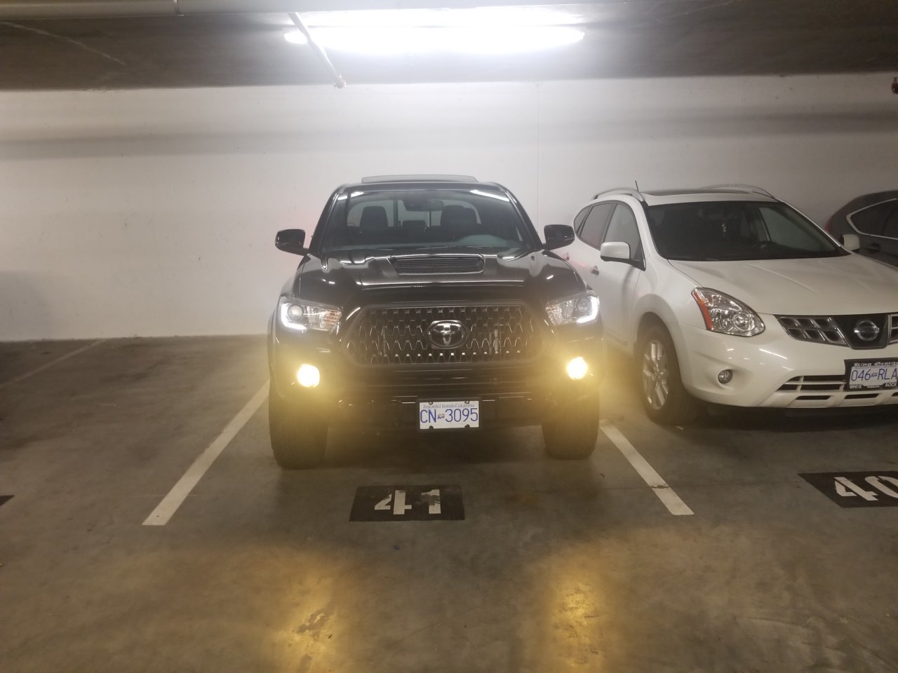

    Killer! I always saw how weak they seemed to cut through the fog on other cars. This is my first time with them and they are the real deal.
    I got a set of LEDs for mine also. So, they only get used in the fog or for offroad dust.

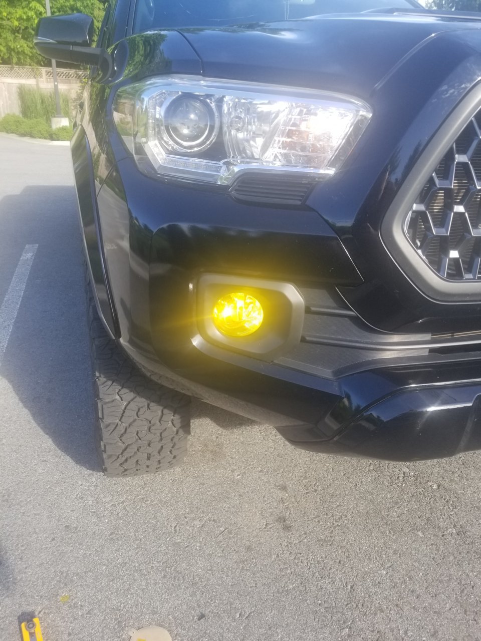

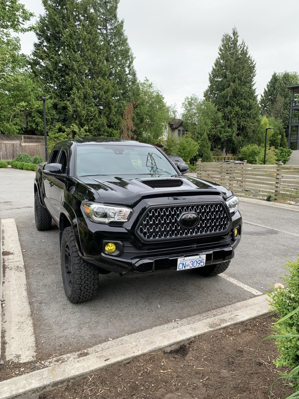

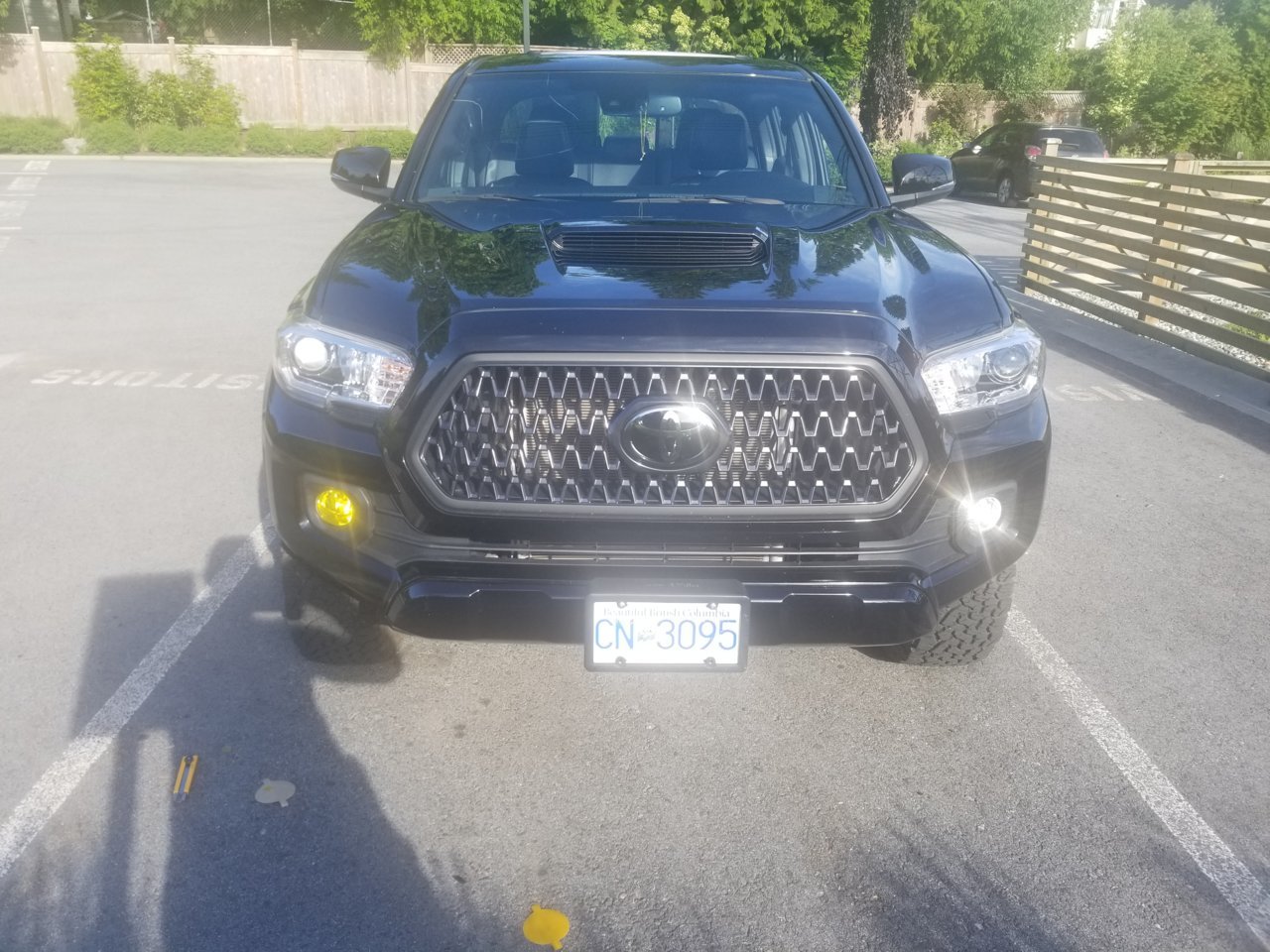

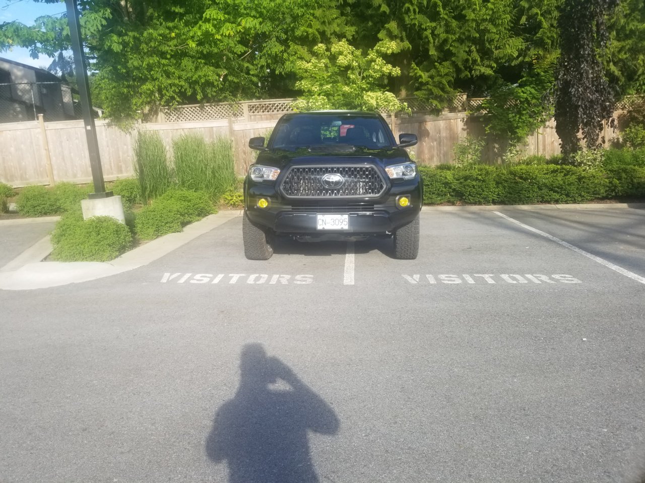

    Old thread, but i recently installed lamin x fog light covers. I think it looks great and the install took me 3 mins, no joke.
    I dont understand why some folks remove the bezel or the whole fog light! Haha! I removed the backing from the lamin x, then just touched the center of the lamin x to the center of the foglight. Then, used my thumb in circular motion from the center to apply the lamin x. Then just cut off the tabs, done.
    Does not get any easier. No bubbles or cracks, looks good.
    Edit: i did warm up my fog lights for about 10 mins before install.

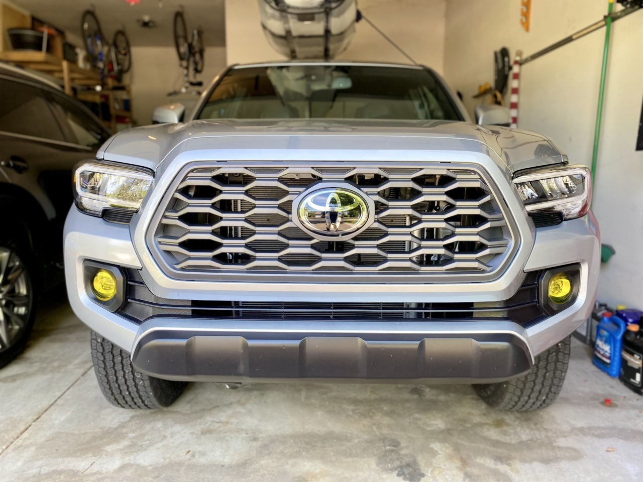

    I did the yellow too....easy to install and looks great on a white truck. My low beam headlight is a 5K HID.

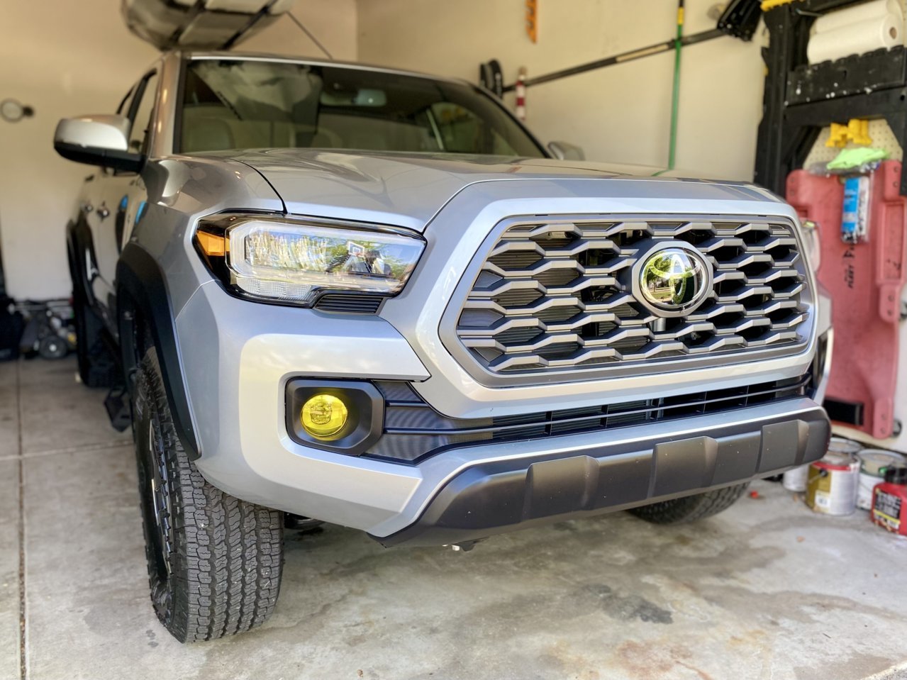

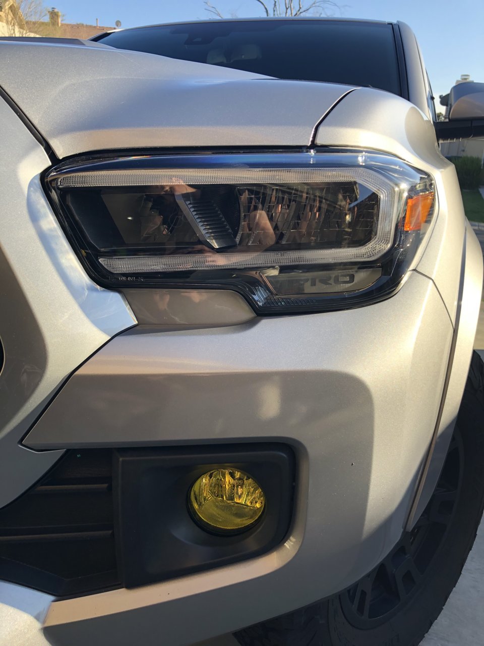

    I installed the yellow Lamin-X over the weekend. It was mostly for protection, as the fog lights on my previous vehicle took a beating in the winter months and both fog light housings ended up cracking. I wasn't sure how I'd like the yellow, but after seeing it on the vehicle, I really like it. I installed by taking the fog light trim off to have full access to the light. It took me longer to get the fog light trim off than it did to get the Lamin-X film installed.
