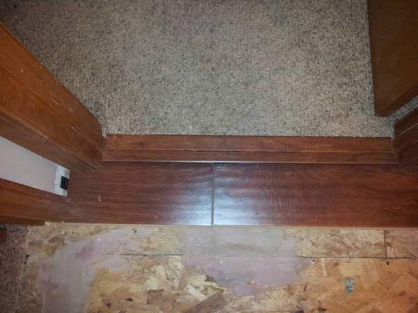

    That is actually exactly what I did. Once I worked down the entryway, I started coming across, ripping the boards so they would go along the wall, but the bottom edge lined up with the board it was attached to, so I had one straight line wall to wall. Then when I got to my doorways, I used a scrap (You will have some by this point, trust me) to help me mock up the width I would need to rip the filler piece down to. You have to get a little creative with your cutting, but once I had it cut right, I snapped on the small filler piece to the boards that were going along the wall, and installed it all at once. And then I had to do a little tapping to get it all back together.
    This kind of gives you an idea. It's doable, but you have to measure and cut carefully so all the edges are concealed by the molding and door jams. Otherwise you get this...
    That will get you a night on the couch...

    I'm thinking you are right about that one. I don't want to think about replacing a piece just yet, but I really don't want to think about having to redo the entire floor someday just because a color doesn't match.
