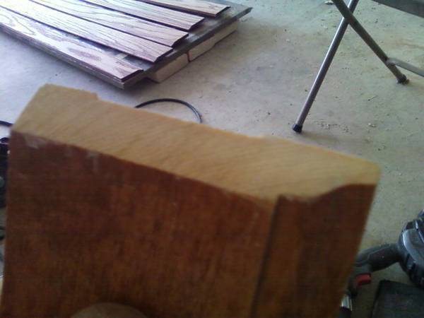

    So I decided to put the theory into practice with some of the scraps leftover from demolition today...Please pardon the low quality pictures, my Android phone died a terrible death so I'm using an older flip phone until my replacement arrives...
    I used the miter saw and cut 45 degree angles like you said Oz, and got this.
    The first thing I noticed was at the very tip there is that quarter of an inch about that will probably need to be factored in when measuring or I will be coming up with several near misses I'm guessing. That's good to know. My wife's grandpa said I'm best off at my skill level to cope the shortest peices, and cope first, and then cut the butt end to length. I am seeing where this makes sense.

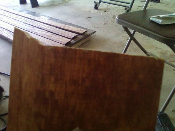

    I used the miter saw to cut a straight line up the flat part and stopped at the curves, just like the strange British man in the video said. Then I took my coping saw (4.49 at Menards, I was thinking they would be more, but it even came with spare blades) and worked my way around the detail in sections. Not as pretty as I would like, but lighting was sucky and I have had a rough day and had a few doses of 12oz therapy. I will not be doing that when I do the final product. (I will also be doing the closet spaces first) Do you think I could touch up the details with a Dremel if I really wanted it perfect?

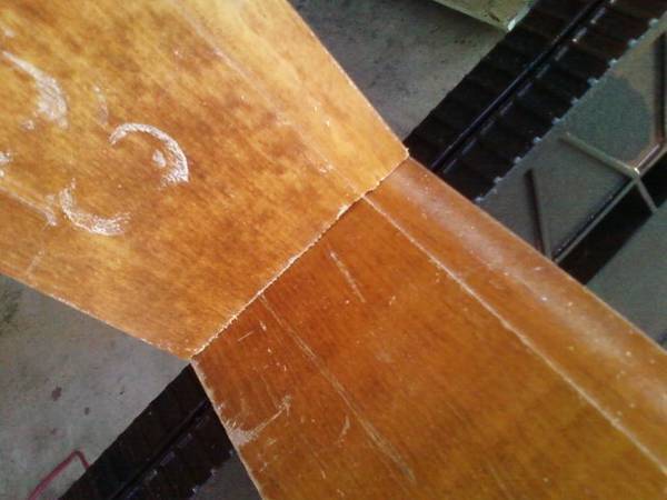

    Stuck them together and this is what I get. Well, sorta. It wasn't exact since I was holding it and didn't have a mock up or anything to attach it to. But I can already see the concept now and how it works. I am also already seeing how it works much better than the two 45's the previous owners shoved together in the corners in the remaining parts of the house. If the scraps weren't in such bad shape, I would consider saving them to redo those later on. I suppose I could always refinish them...or do like the previous owners did and go to Menards and say "give me the absolute bottom of the barrel cheapest stuff you have." I'll probably just end up redoing those down the road. Oz, need more firewood?

    I think I am already noticing something I did not do right. I did not go in at the angle like you did there. I may play around with this some more tomorrow. I can see where that would have made the cutting a touch easier...

    Back beveling will make it easier to get a tight joint because only the leading edge is actually making contact with the adjoining piece
