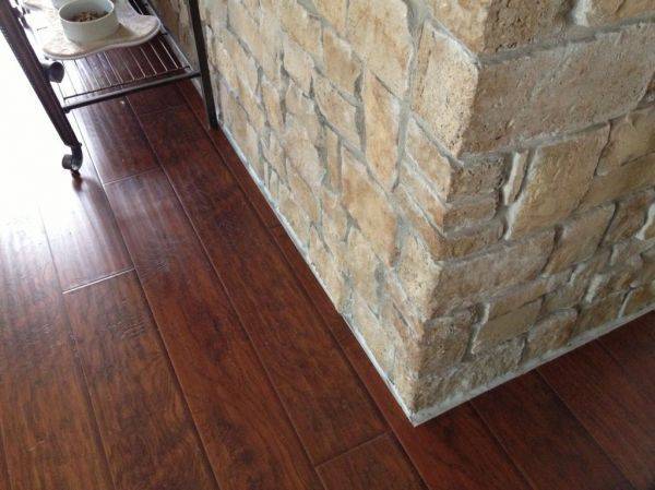

    here ya go buddy. pick of the finished product. the stone is very uneven so molding wasn't an option. i didn't think of undercutting the stone and sliding the flooring under it for a seamless look. so i filled the gap with gray caulking and smoothed it out. laid down a tape line first for a straight edge. is it perfect? nope. the gray caulking kind of matches the stone grout lines. there are probably a lot of other options i could have went with but i'm not an expert.

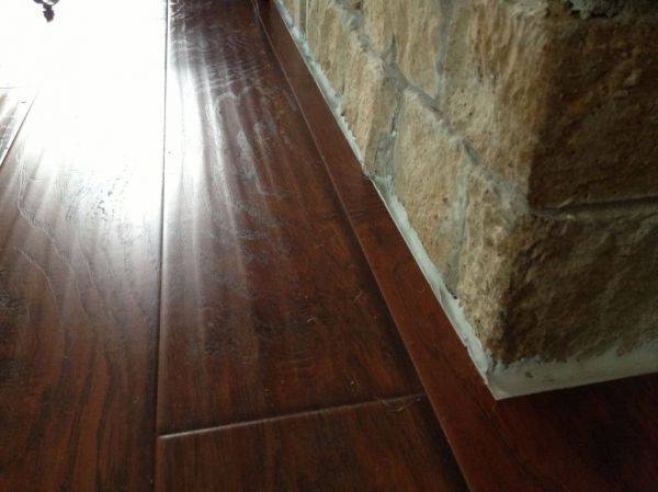

    here's more of a close up pic. the caulking is down and i'm happy with it. if anyone has a better idea that doesn't involve me pulling up my flooring or removing the caulking i'm all ears. I've found during my house remodel that caulking is my best friend. It makes my white trim work look professional. For you and other guys that have wood baseboards and wood trim that involve coping. Much respect guys. My walls aren't straight at all and my cuts perfect. But caulking is my friend.

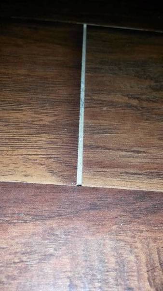

    500][​IMG][/url]
    Hmmm...any ideas why my flooring would suddenly decide to do this in several places? Is laminate that sensitive to temperature change?
  8. Dec 14, 2013 at 7:48 PM
    #268
    OZ-T
    OZ-T I hate my neighbour
    Dec 15, 2009
    #27584
    50,587
    Peter North
    British Columbia
    Yes
  9. Dec 14, 2013 at 7:54 PM
    #269
    cdikkers
    cdikkers [OP] Minimum Wage!
    Nov 12, 2009
    #25848
    267
    Casey
    New Berlin, IL
    Speedway Blue '05 PreRunner
    So...what now? Does it go back when it warms up or do I have to take out some baseboard and quarter round and do some tapping?
  10. Dec 14, 2013 at 7:56 PM
    #270
    OZ-T
    Dec 15, 2009
    #27584
    50,587
    Peter North
    British Columbia
    If you left a 3/8" gap around the perimeter ( under the base ) it should expand and contract freely on it's own
  11. Dec 14, 2013 at 7:58 PM
    #271
    cdikkers
    Nov 12, 2009
    #25848
    267
    Casey
    New Berlin, IL
    Which I did. So the gaps between planks just happen and open and close?
  12. Dec 14, 2013 at 8:01 PM
    #272
    OZ-T
    Dec 15, 2009
    #27584
    50,587
    Peter North
    British Columbia
    Generally the end joints stay together and each row expands on contracts as one , is it possible that one end of that row is pinched and can't move and the rest of the row has pulled away from it ?
  13. Dec 14, 2013 at 8:04 PM
    #273
    cdikkers
    Nov 12, 2009
    #25848
    267
    Casey
    New Berlin, IL
    That ccould be. The fridge is on the ones in the kitchen. The hall ones are near the hall tree.
  14. Dec 14, 2013 at 8:15 PM
    #274
    OZ-T
    Dec 15, 2009
    #27584
    50,587
    Peter North
    British Columbia
    It would make sense that one end of the row is pinched
  15. Dec 14, 2013 at 8:22 PM
    #275
    cdikkers
    Nov 12, 2009
    #25848
    267
    Casey
    New Berlin, IL
    Alright. I'm just going to try not to think about it for now. I'm stressed enough about the bathroom.
