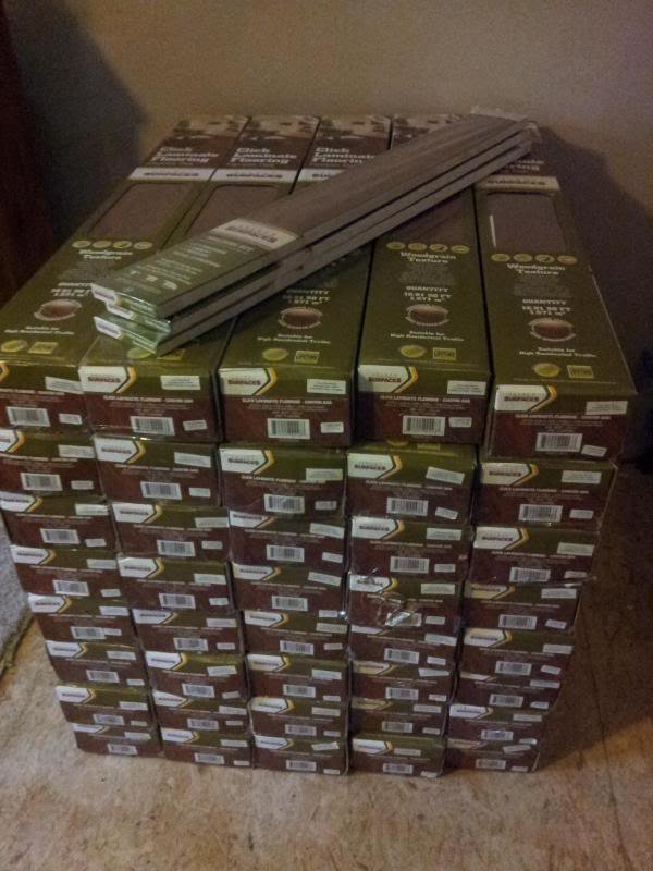

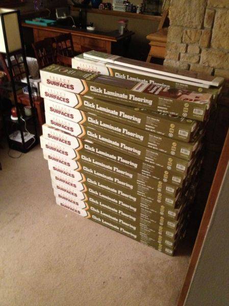

    kinda looks the same huh?

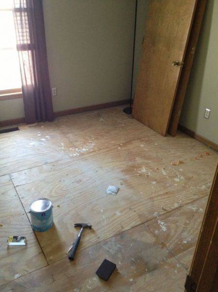

    looks like crap

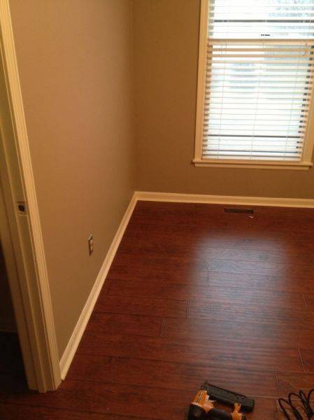

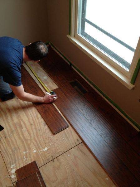

    but once ya get it, it's really nice flooring
