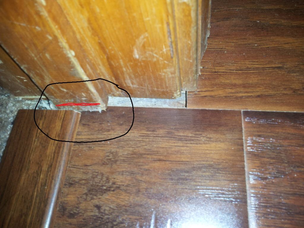

    Rip a piece , make sure it's gonna fit and drop it in with some glue

    If you don't want to take it out and cut another one do what oz said, and for the little gap maybe just use some brown caulk. No big deal. You will get the hang of it, i bet your next piece that goes under the casing will come out better.

    ^ is the way to go if you dont want to take it out and cut a "L".
    Cut the middle of the door and place that T underneath.

    Glue a piece in and putty it up so the cut isn't real obvious.
    Also, you should cut your threshold to fit around the center piece of your door frame.

    You have to cut a smaller piece and then use a small pry bar to "click" them together. Use putty or brown caulk to cover the crack at the door trim.
    Instead of cutting the threshold... cut the center piece. Then put it in between.

    If you cut it like this, you'll still be left with a gap in the center of the door frame that the threshold is not under. It's not difficult to notch a threshold, and the threshold is much cheaper then a door frame. Your wife wants it done right, notch the threshold.

    I would just cut a perfect piece and glue it in. But if you have any other doorways trim just a little on the bottom so flooring will slide underneath.

    The transition piece ended up not lined up with the center because the carpet got trimmed just a touch to far back. When I mocked it up before I put everything in, that was about as far forward as I could put it with it still covering the carpet. I do have the door jams trimmed so the flooring will slide under, I think this was just the product of poor measuring. My other transitions are fine. I have some remains from pieces that I trimmed lengthwise, so I will probably cut a little piece off, remove the transition, and try to slide it in from the back and tap it in there. I have to work today, so not sure if that will happen today or not.

    Transition isn't supposed to be center, it's supposed to be under the door. When the door is closed, you should only see either wood, or carpet depending on which side of the door you are standing on. Assuming where you have it is the side the door hangs on, then it's in the right place.
    I was talking about the gap between the threshold and the door frame. If you cut the edges with an L, you can make it sit flush.

    I follow now. I bought an extra case of transition pieces that I figure I will play with somewhere down the line to make that one look a little better. I seem to be having issues measuring stuff and cutting it right. What do you use to cut something like that?

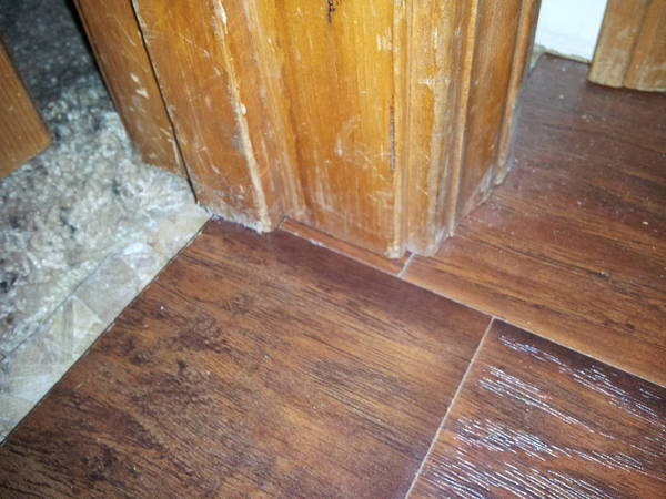

    Ha...
    To all you haters out there...
    Wait, there haven't been any, you've all been really supportive. Onward and upward. Living room starts tomorrow!

    That works!! Looks good

    Looks good man! Now putty that crack, and you'll be hard pressed to even see it.
