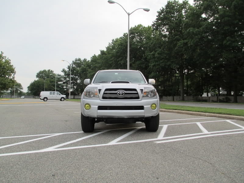

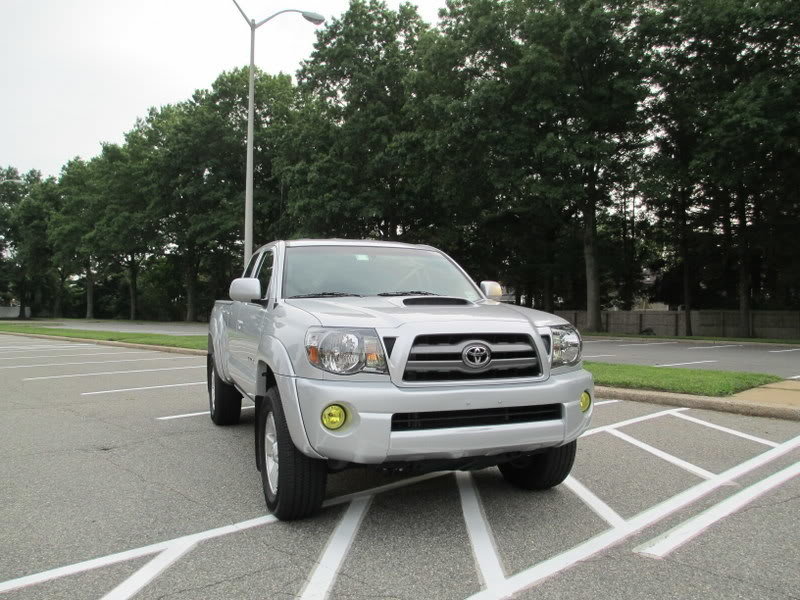

    Yellow fogs.. :)

    Looks good Jon! I've always been a fan of yellow fogs on Tacomas. Some people hate it thought for some reason.

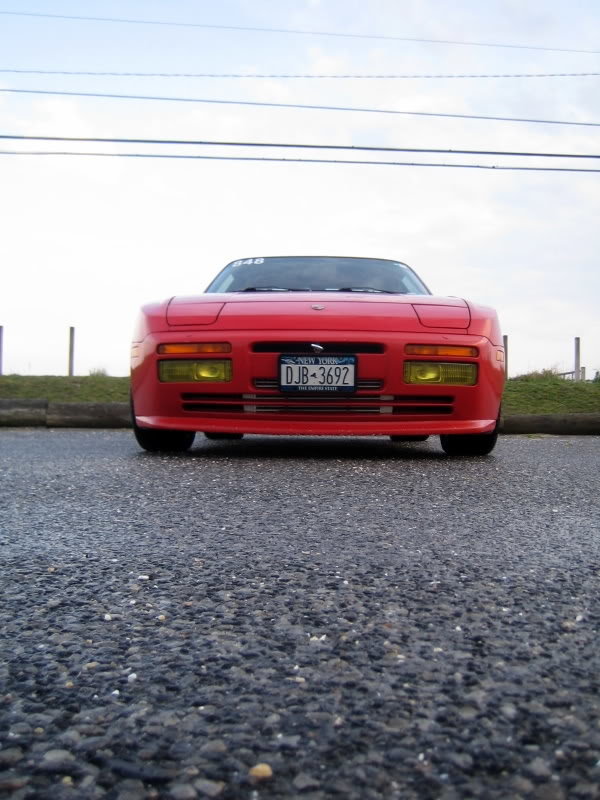

    The pre-cut film for the Tacoma from Lamin-X is a bit of a pain to work with. The Tacoma fogs have a very concave lens, this with the Lamin-X precut film being cut basically the exact size of the lens makes it not very forgiving with the alignment. I would possibly consider ordering a bulk sheet, like a 1x1 (or whatever sizes they offer) as this would give you more room to work with, then use a razor to trim the excess off. Just remember, work from the center out and go slowly. There is a good video on the Lamin-x site that shows installing on a circular fog lens which is helpful, though the lens they use is basically flat, so you just gotta go with it.
    I have some experience using the Lamin-x for my other car and found this one more annoying than challenging. I took the fogs out and had them mounted right side up in a bench vice to make it easier to work with. Still my drivers side has a small edge that is peeling up :(. I am pretty anal about 'the details' so it bothers me, but its not even noticeable unless staring right at the fog light head on.
    Wish i had known this, but the guy who tinted my windows installs Lamin-x also.. next time i will know not to waste my time and let a pro do it!
    I am a big fan of yellow fogs, not sure why. :). I put Lamin-x on my other cars fog / driving lights also.. everyone knows the car by the lights alone.

    X2. ^^^ I also bought the pre-cut ones and it took me a few tries to get them centered on the fog light but it wasnt a huge PITA.

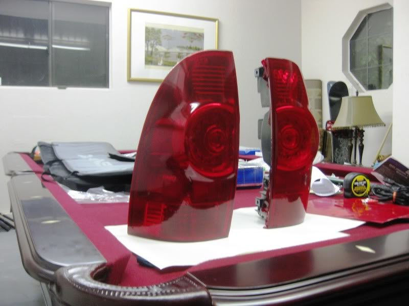

    Its actually pretty. Just takes patience. Giving tinting a try for the first time.

    Dang that all red looks great is it laminx film also?

    No i bought the tints on ebay from rvinyl. Pretty good material and for only 8 bucks!
