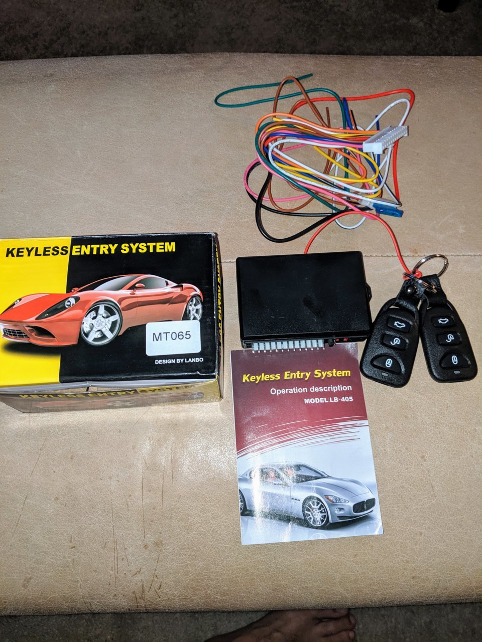

    I bought the cheap keyless entry system for my 2019 Tacoma SR . The instructions are pure crap
    If anyone had this kit I have a few questions about the install..
    First off all I want is to be able to lock/ unlock the door. I don't want the horn or the lights.

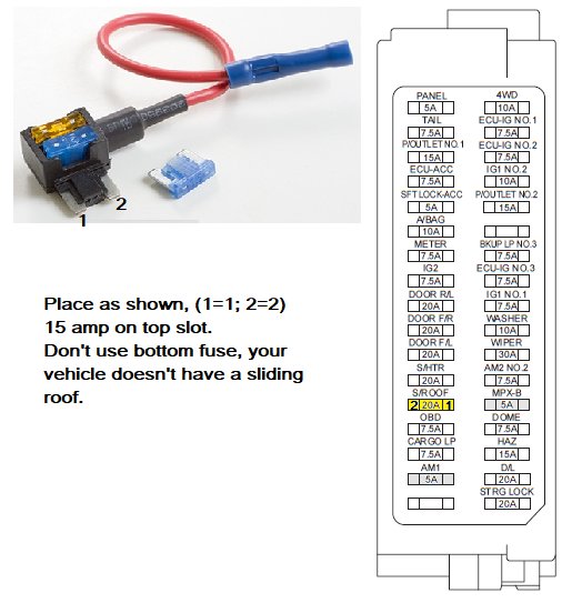

    1- the red power wire where are you looking it up? If it's the fuse box, what fuse.
    2-the black is simple, right to a ground.
    3- unlock wire, what color is it on the unit and where on the IC2 connector does it go?
    4- lock wire, what color is it on the unit and where on the IC2 connector does it go?
    5- any other install tips and instructions are appreciated.

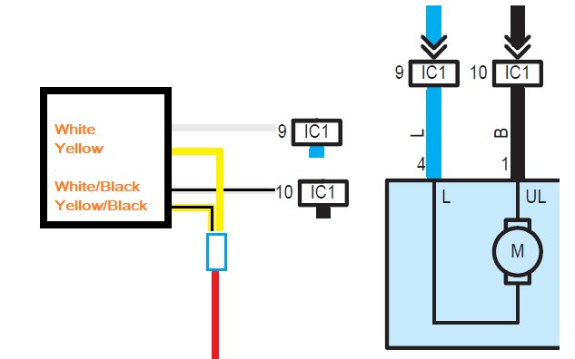

    This is as close as I understand the "instructions"...:playball:

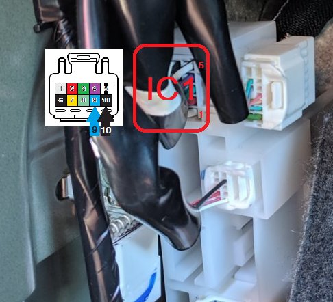

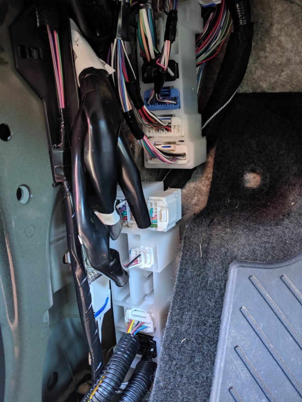

    Caribe, thanks for all of your help. I opened up the kick panel and there were a ton of connectors under there. I give up and have been defeated. I have no clue where to start. :frusty:IMG_20190524_111401.jpg

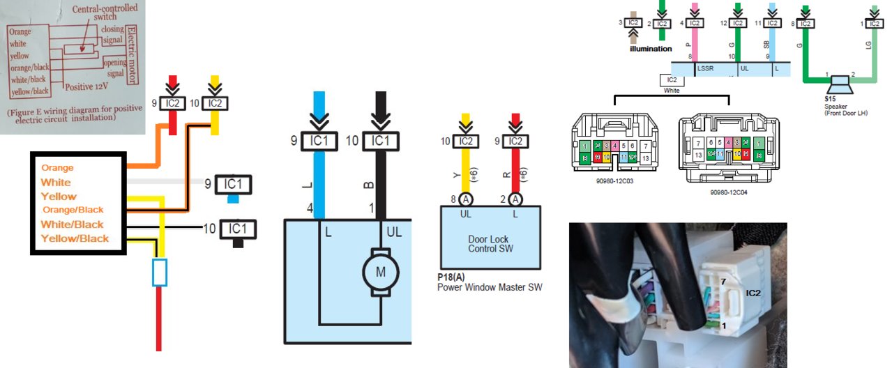

    Another, but still not 100% sure. These seem to be more to your vehicle in order to unlock/lock both doors. The instructions are terrible.
