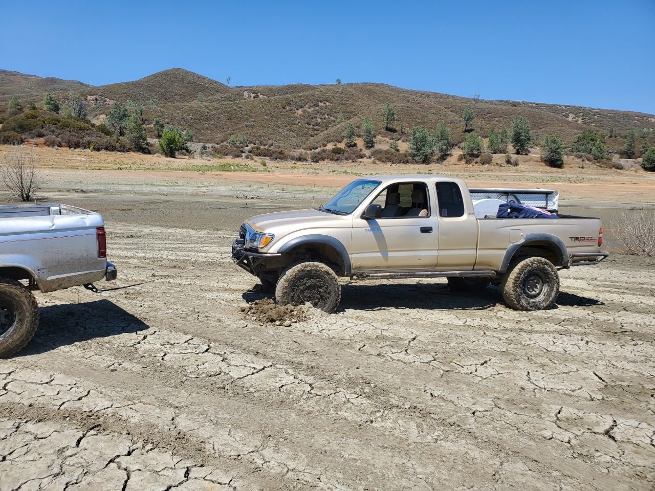

    I've got a first gen with the TRD rear locker and also have a Smittybilt winch I'm super happy with. I pulled myself and buddy out of some of the worst mud ever. I think my buddy went in knowing I was going to get him out.
    Does anyone have experience with land anchors for winches? My favorite wheeling area is the bottom of a dry lake bed on BLM. The bottom of the lake bed is either muddy or sandy and the sides are rocky from the waves lapping against the shore and causing the soil to erode (when full).
    I have 300' of straps and winch line, all added up, but there are times I want to get risky but no tree anchor points.
    I've looked at Bush Winch from Australia which is an auger system, and several Pull Pal type systems which resemble a boat anchor.
    Whatcha got, how does it work for you?
