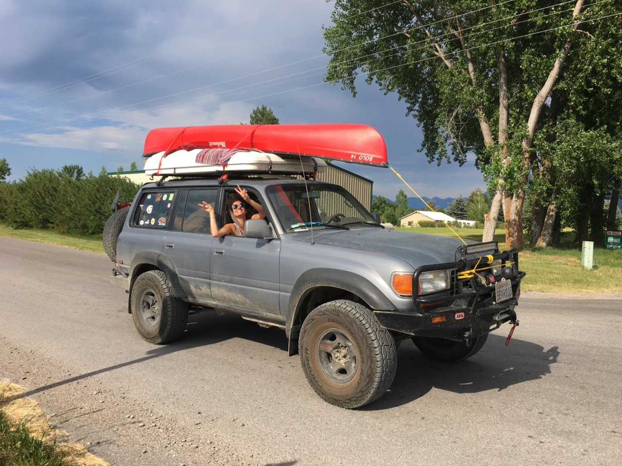

    Edit: my current rig, now for sale

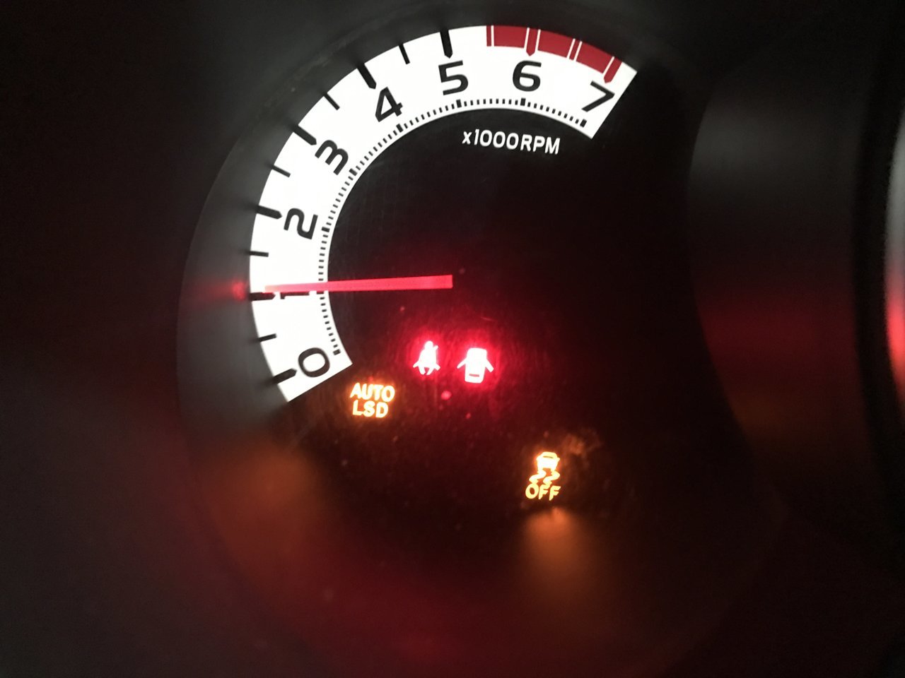

    No, but the off road still has the elect. "Auto LSD" when VSC is turned off (under 30mph I believe).
    This is what I get when I turn off the VSC on my Off Road.

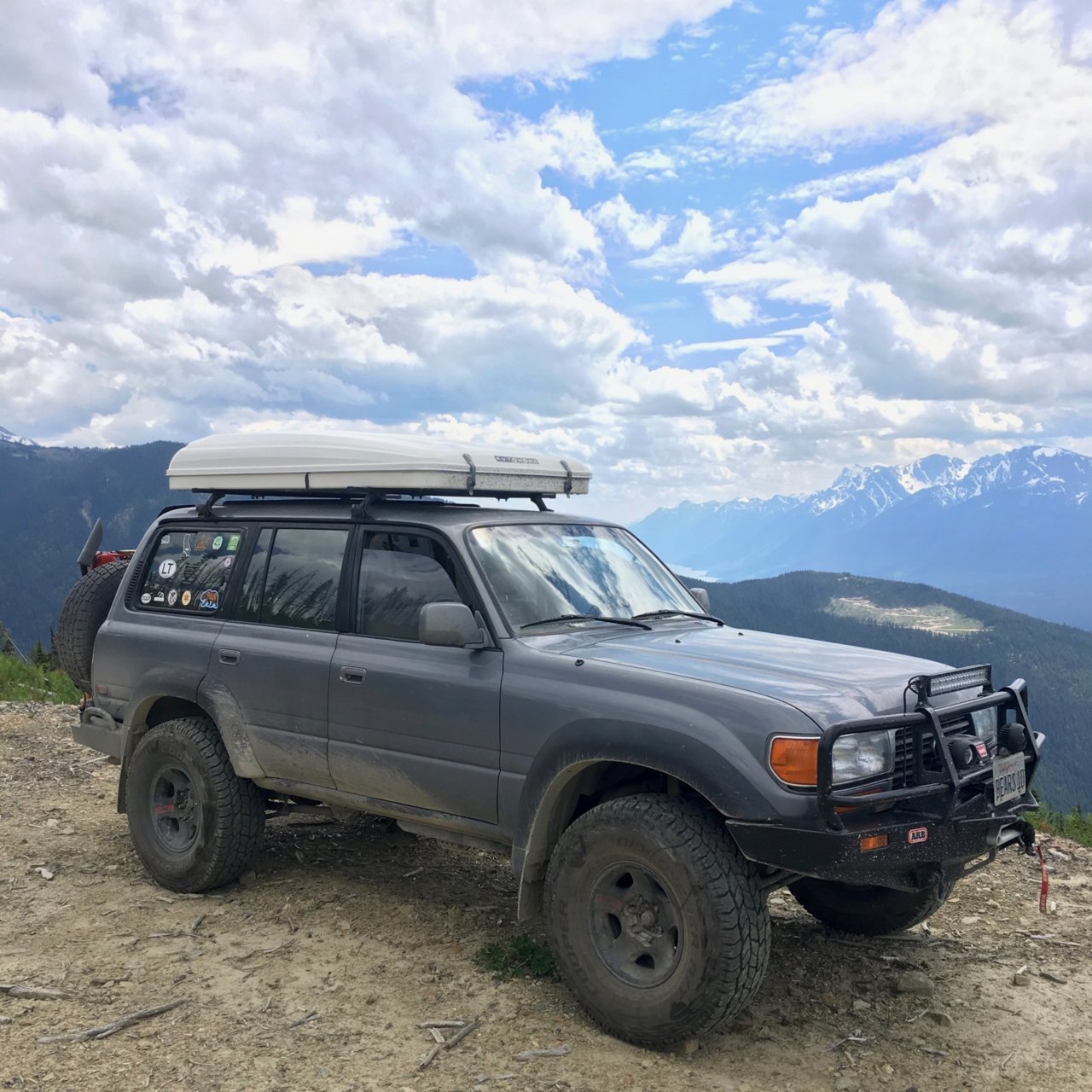

    I have a suspicion I'll get along better with the long bed. I took the seats out of my cruiser a couple years back and never looked back. That's almost 7 feet with the seats out and I routinely fill it up. Also a little skeptical about being able to fit gear plus an elk in the shortbed. I'm 6'4 and if I design a sleeping system (and sell my airtop) i'll want the space. Paying more for a shorter bed is a hard sell
    Edit. Skis. All my skis are between 185cm and 190s, which is about 6ft. I ski a decent amount (not as much as others on here i'm sure). probably 3-4/week or about 50 days a season.
    Convince me on a shortbed? I think it looks more balanced and probably drives more balanced (on and offroad).
    This was the setup for most of last summer. My GF and I did a 2 month road trip from CA to the Yukon then to Montana (where we live).
