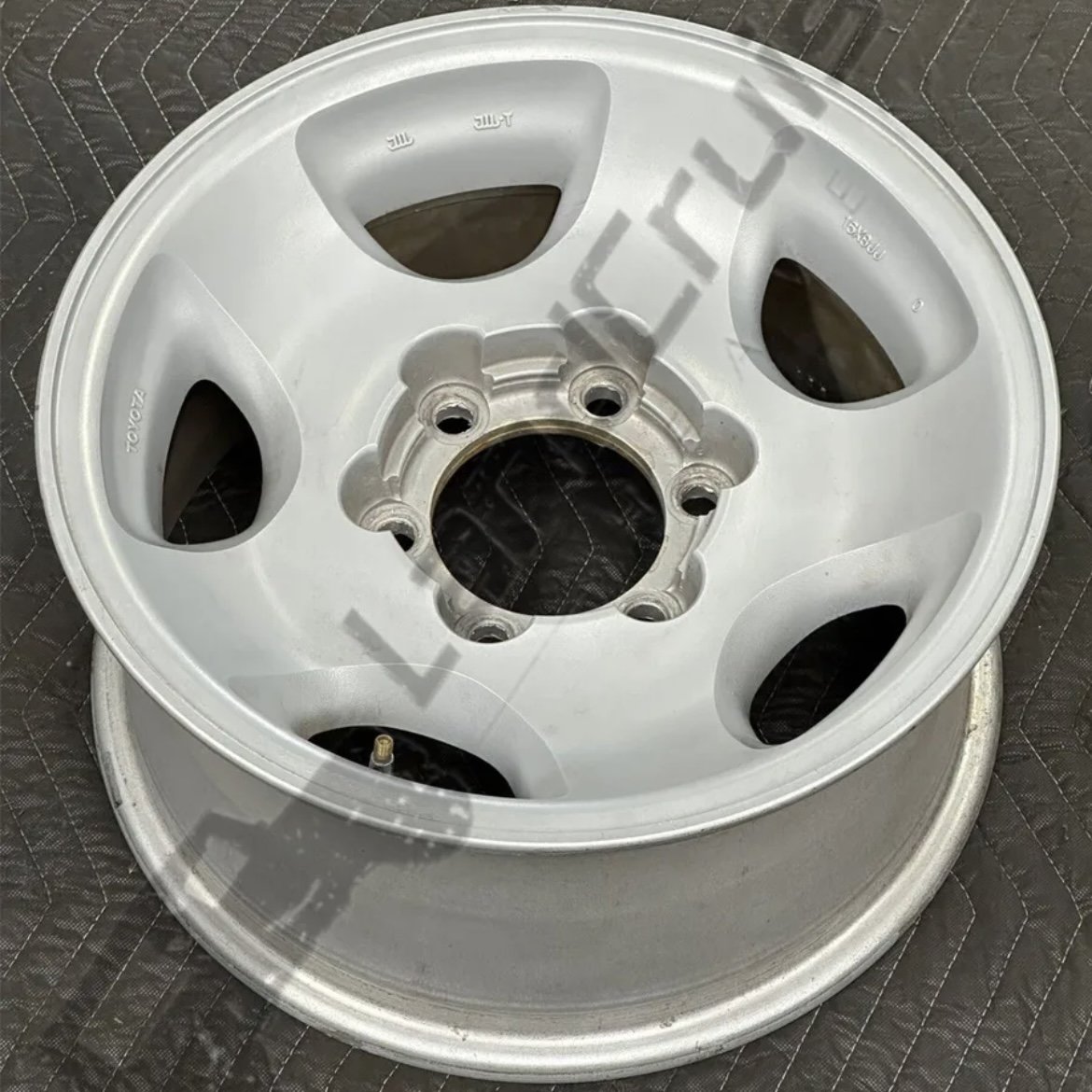

    Anyone ran these 80 series Land Cruiser wheels on a Tacoma or seen it done? Looks like they would have a good amount of offset, which I’m interested in.

    If I recall correctly, those LC wheels are 16x8 +0mm offset. They can fit on a 2nd gen Tacoma.

    @Blutic be careful with the lug holes. It looks like someone mounted them with regular acorn and mushroomed the holes. Those wheels take a Toyota mag style lug.
