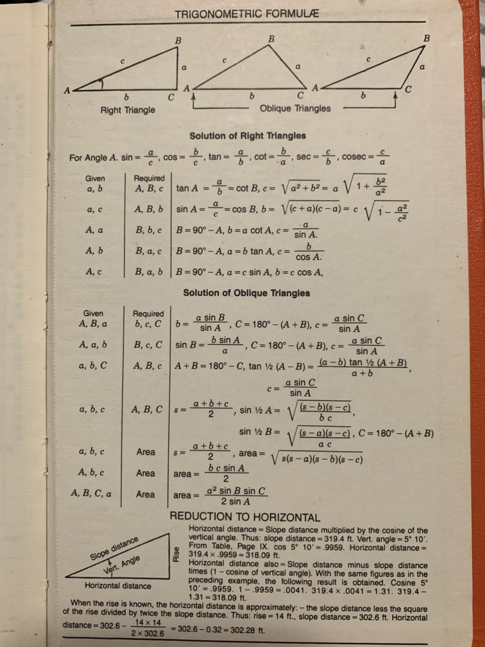

    As mentioned, if there’s much up/down you’re gonna have to solve the triangle for the slope and correct, or you won’t be close just dragging a tape measurer through the bushes.
