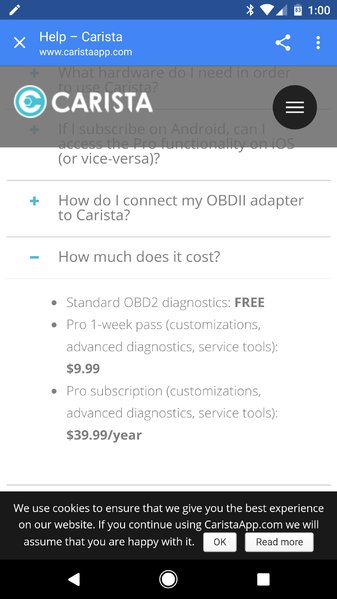

  20. Dec 3, 2016 at 11:01 AM
    #40
    drwx
    drwx Well-Known Member
    Feb 1, 2015
    #147640
    2,423
    M'boro, TN
    2017 DCSB TRD Offroad 4x4 BBP
    I think carista is subscription, so not a one time fee
