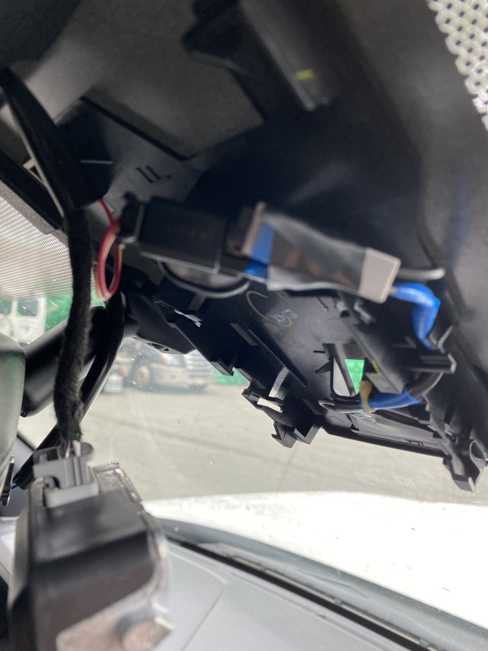

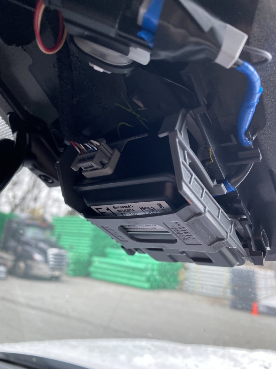

    Not looking to start an arguement about shutting it off/on. Just trying to show a fix to LDA that I can not turn off despite picking 'warning OFF' and selecting the lowest sensitivity levels. This DOES also turn off the pre-collision and distance cruise control. I wanted none of these options (technology package) but was told -and possibly lied to- that all the trucks in New England have this package from the factory. At the end of the day I wanted a NEW access cab, 6sd manual, 4x4, V6. Again not trying to start a fight. If you don't like this idea move along.
    Get in the passenger seat

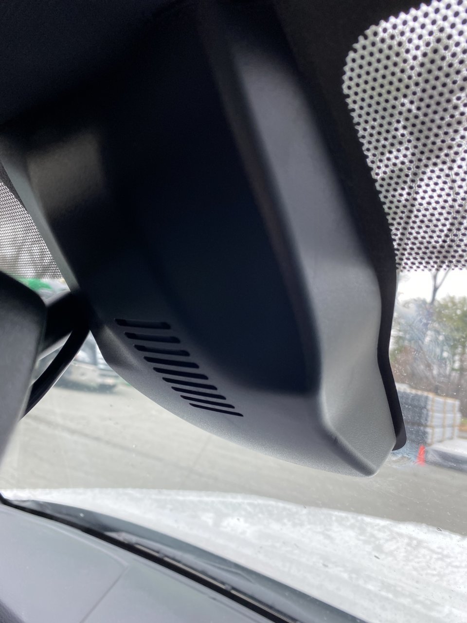

    Grab the camera cover behind the rearview mirror and ever so softly push it toward the windshield as you slide it down toward the dash. It will only go down about an inch. If you tug too hard or try to force it out you will break one of the four small tabs that hold it place (ask me how I know this).
    With you middle finger and thumb push inward on the center of the gray retaining bracket as you also push it upward toward the roof.

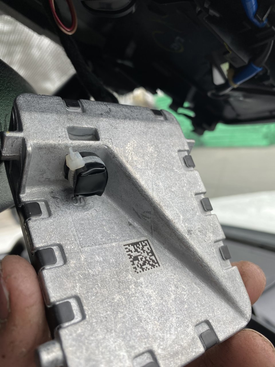

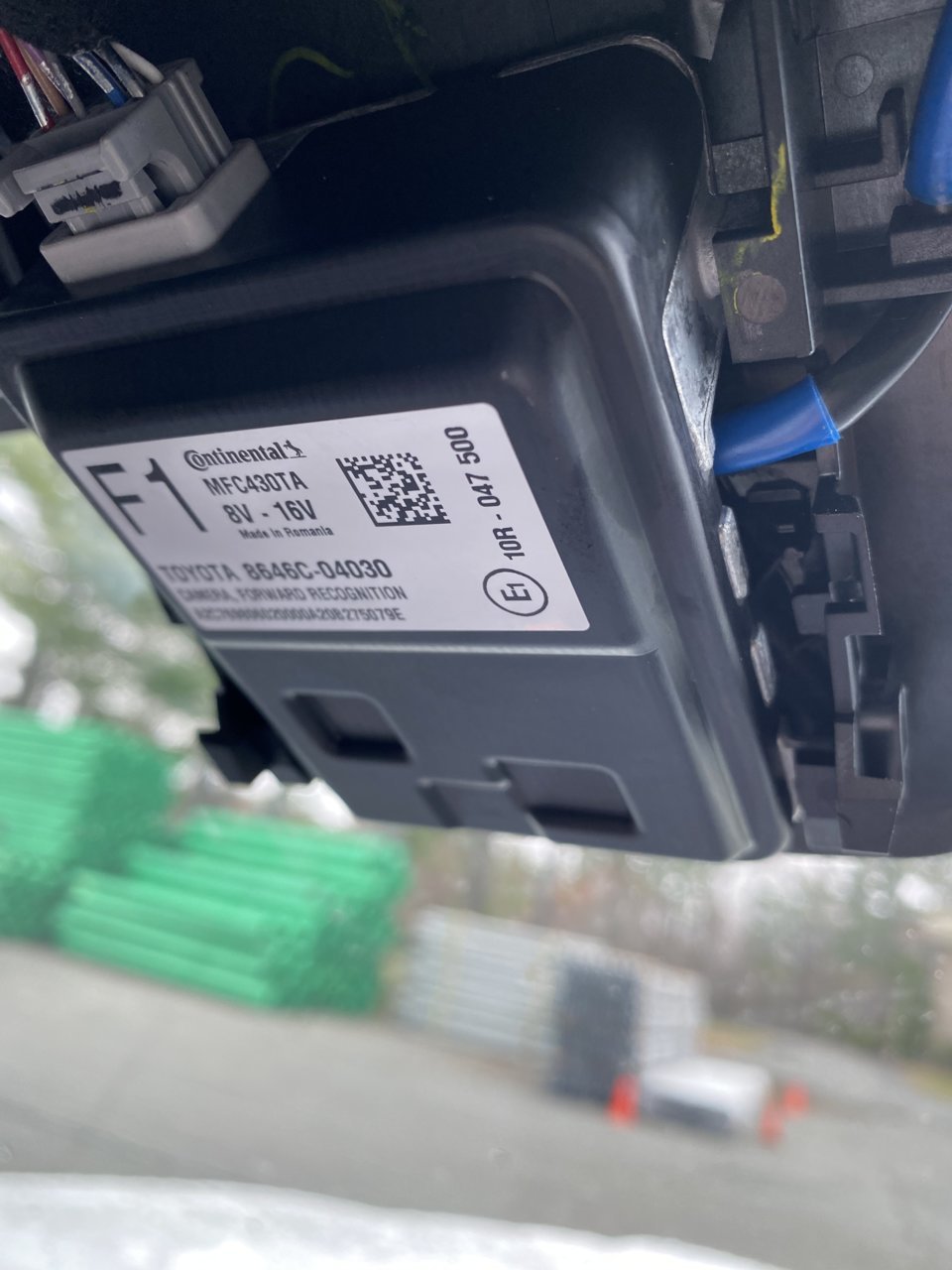

    The camera is basically sitting in the bracket attached to windshield. Push it upward toward the roof and it will slide out.
    DO NOT unplug the camera or the lense heater (black triangle with blue wire). It will throw a message on the dash screen, flashing orange triangle in the speedo, flashing pre-collision off in the tach.
    I took about an inch of electrical tape and cut it lengthwise in half to cover the camera lense at 12&6 and 3&9 (if you can only read a digital clock ask someone what that means). Then put a small ziptie to hold it in place. I'm sure you could just wrap it with a longer piece of electrical tape to do the same job.
    I was leary to cover the lense with long pieces of tape since I have no idea what triggers the heater or if it gets hot on the backside.
    Once you drive for about a 100' and sometimes less the dash screen will say 'front camera unavailable see owners manual'. The green LDA icon next to the outside temp will turn a dull amber. The pre-collision OFF symbol in the tach will turn on. I have driven for over an hour and no other warnings or symbols turned on and nothing ever flashes.
    Not the 'modification' for all, I know that. But if you want crap to stop beeping at you locking up the brakes when nothing is even close without buying a 4yr old truck that someone likely tooled on then here is a solution.
