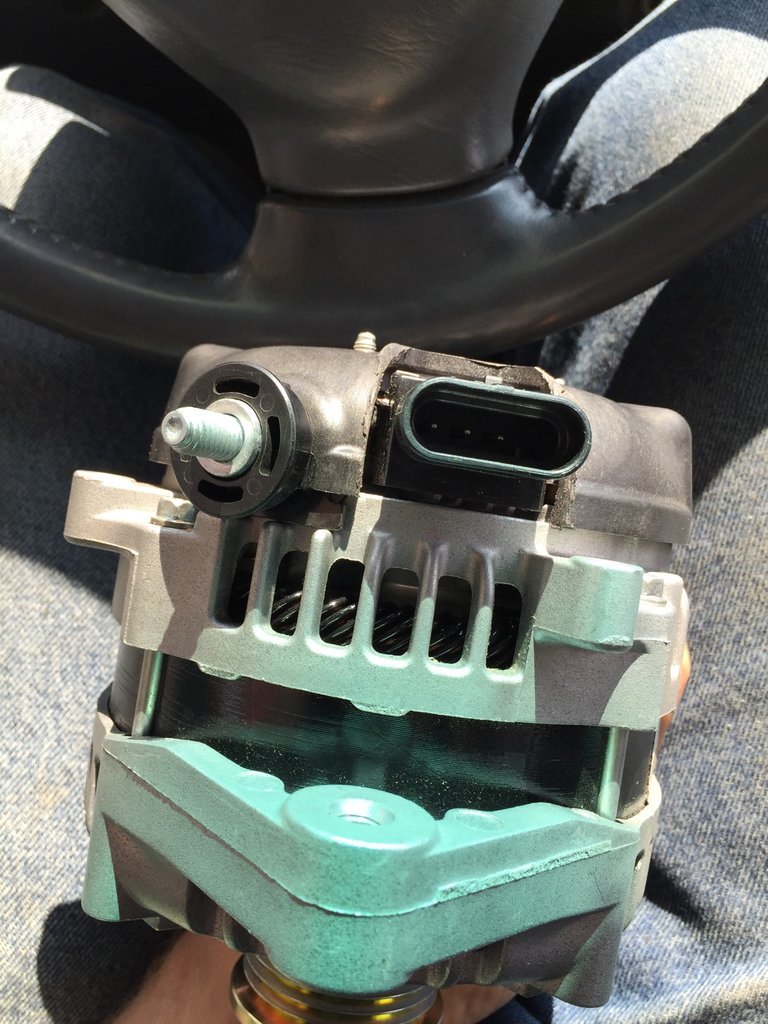

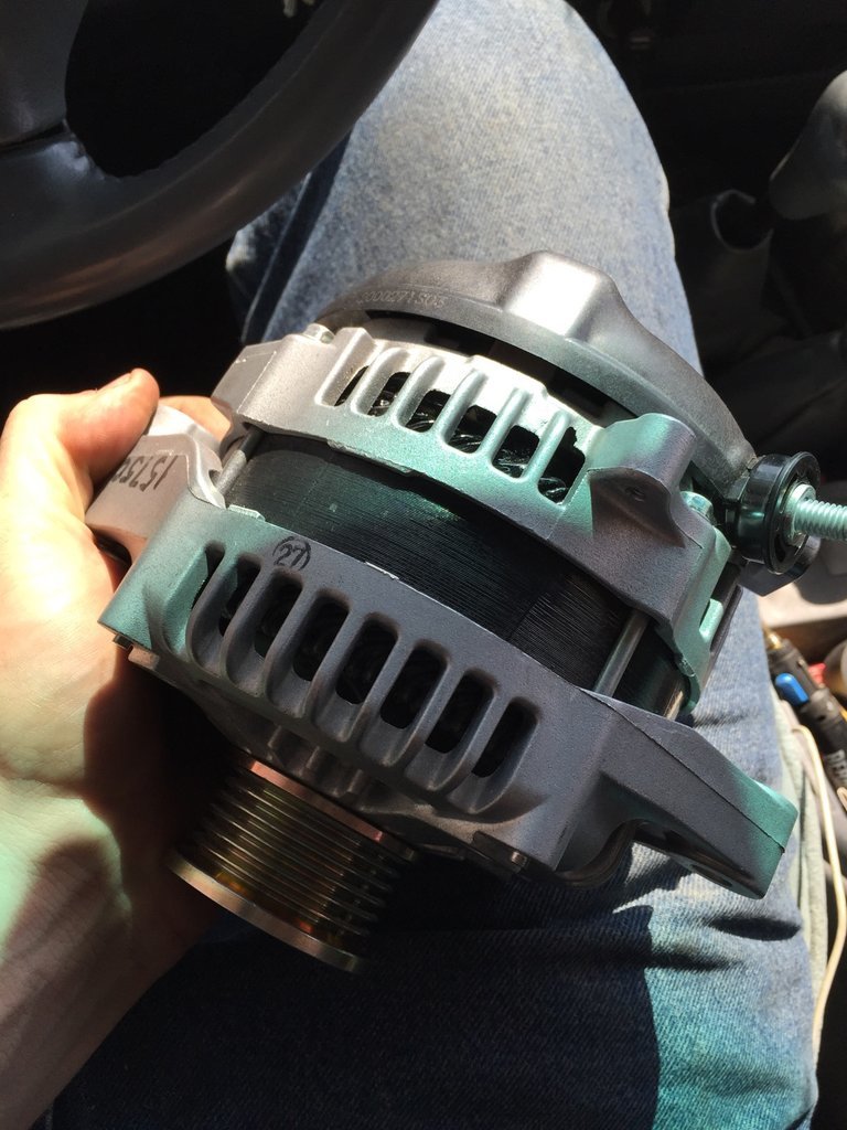

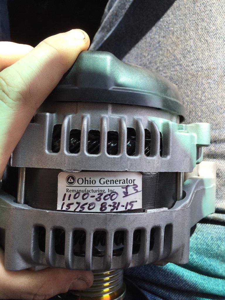

    Getting ready for the swap... Ohio gen 300a alt I picked up brand new never used tested it today pulled 320a on a test bench
    I also got the plug from the electric motor place I tested it at... And they told me how to take the face off so I can rotate the plug/ positive post configuration to match stock location.....
    Oh and the kicker I picked it up for only 200$

    Lol shit just popped up on Facebook one day guy found it in a car he bought... Lol... The adjusting mount side is threaded so I will have to drill it out... It's also slightly thicker on that side as well and I will need a larger spacer on the block side of the mounting bracket... Already found nice spacers at menards just need to figure out a bolt size and how big of a spacer I need
