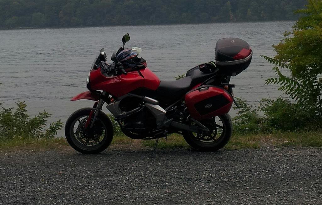

    I Dont have any pics of bikes in the truck...But I own a Kawasaki Verseys loaded down with full side and top cases, I easily haul in the bed of a DCLB. It weighs 15 #'s less, and 2" shorter seat height but close. I have also hauled my dads Honda Shadow many times(536 #'s).
    I have had no problems with either( my dad has dropped his shadow a few times, but he is a older guy who now uses a trailer).
    I always use 2 arched ramps. 1 to run the bike up, 1 for me to walk up. I prefer to park with the truck facing downhill or rear wheels in a ditch, but have loaded on flat as well.
    Put the bike in 1st and drive it up as you walk.
    To unload I put in first with the bike off and slp the clutch as we walk backwards.
