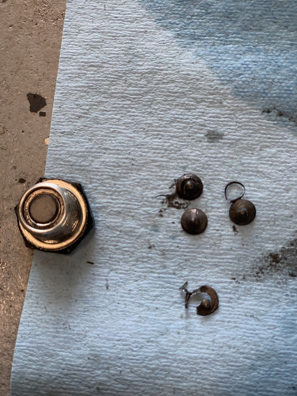

    Hey everyone... So some off you know, I had an issue with Toyota having 6 washers on my oil drain plug and I noticed it when I did my first oil change. (found here). I really didn't care because there was no harm done. I feel this is different.
    First off, I should have listened to you guys and not Toyota, because doing the rear diff oil change that Toyota recommends, is FAR too long.
    Anyway here's my story: I'm headed on a big trip and I'm almost hitting 19,000 kms and wanted to do the rear diff change. First the smell was too much.... just smelt like burnt oil. Then when I too out the plug and found this huge piece of metal, I absolutely lost it.
    I called Toyota Canada but they were closed but I'm calling when I get back from my trip.
    Do you think I'm over reacting here?

    Normal, nothing to worry about.
    Really, I’m not joking. It’s normal.
    Refill with fluid and forget about it.
    It’s fine.

    You're overreacting and not the first to find that chip.

    It’s just a shaving from the axle housing that wasn’t blown out. It hasn’t been ran thru the gears, obviously, and has been stuck to the plug since it got the 3rd & gear oil.

    It's left from machining on the housing during manufacture.

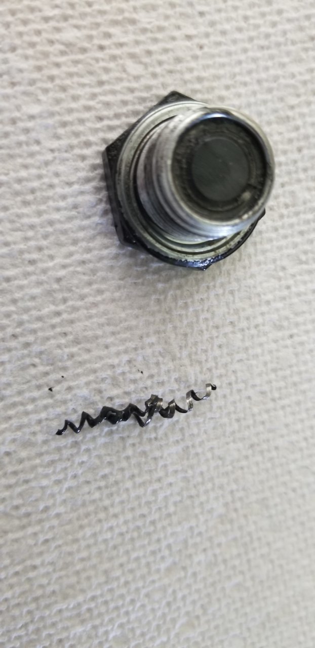

    That last pic is mine…yep, this is not abnormal. From the machining process.
