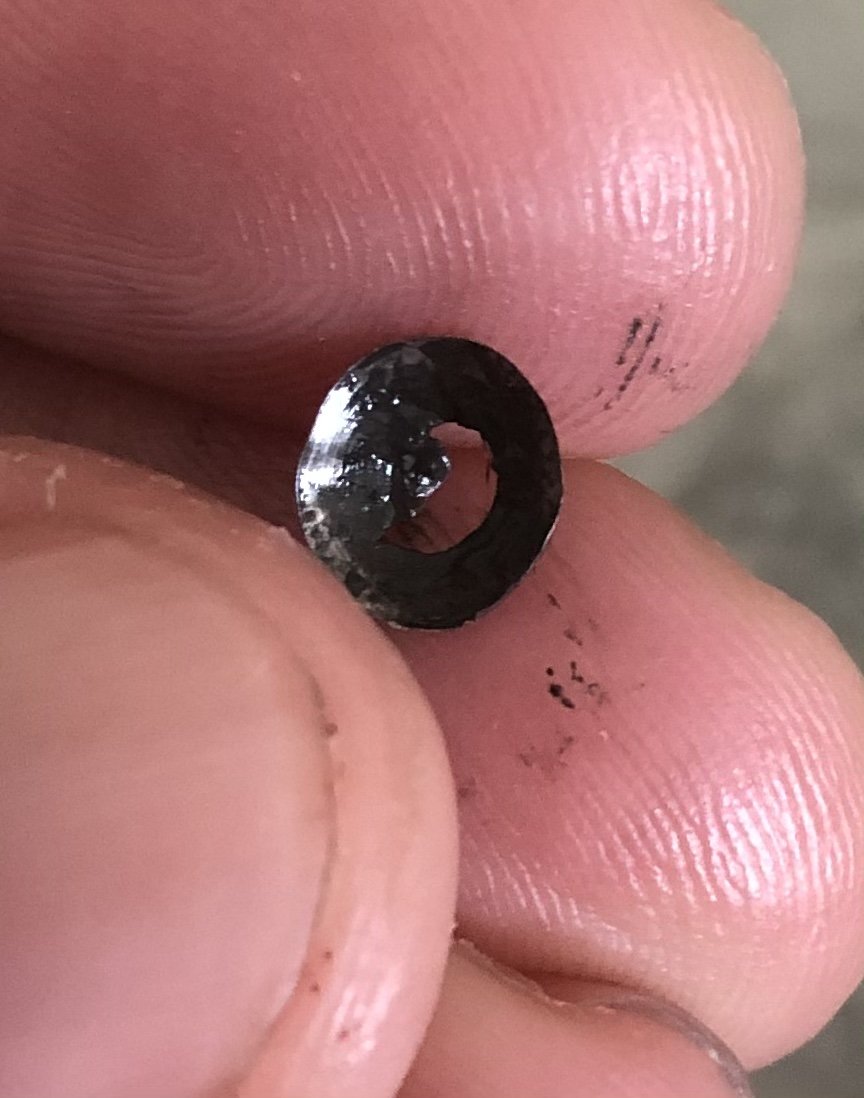

    I posted this in the thread for the rear diff fluid change, but maybe it’ll get more eyes in its own thread.
    Did my first rear diff fluid change at 65K. Bought the truck with 32K on it, doubt it had ever been done by the prior owner.
    Found this chunk on the drain plug magnet. Nothing else of note just the typical sludge. Any reason to be concerned? Certainly doesn’t look like it’s from a gear. Hard to see in the pics but it’s got a concave shape like a little dimple, with a little tiny sort of flap at the tip.
    Could this be leftover from the manufacturing process for the case itself or some component therein? My truck runs great.
    But, this little guy has been in a baggie on my desk every since, nagging at me.

    Looks like a piece from when a hole was drilled, the very last chip and it got missed upon clean out when it was made. Looks undamaged so probably no harm done from it.

    I wouldn't worry about it. Usually if the diff is failing you'll have a thousand little shiny pieces, not one big piece

    I found a pretty similar piece in mine when I changed the fluid at 100,000

    I've seen this pop up a few times on TW, all pretty much identical stories as yours. It's thought to be part of the manufacturing process from drilling a hole, as mentioned already. I wouldn't worry about it.

    Thanks everybody, especially @TnShooter for the link. Those little cones look pretty similar. Worries gone!

    fairly common. i found one on my first change, so have all my friends with Tacomas as well.

    The ritual has resulted in no issues with the rear diff.
    If you found a similar chunk of metal, it’s from the manufacturing / machining process.
