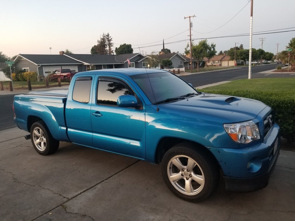

    Started looking into this. the Lexus gx/lx 460-470 larger set up swaps over... problem is its 6 lug...
    Any one swap say, Sienna 5 bolt or say ???
